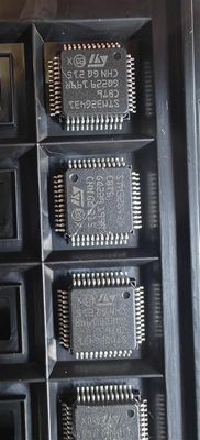

Hi All
I work with Mihai Beffa, who started this thread. I managed to make some tests with the bad boards.
For context, the card is a slave on an I2C bus. Measuring the SCL line, I realize it can not be driven low enough by the master (don't go lower than 1.92V)
Decide to make the SCL (PA15) output push-pull (no I2C initialisation, no master connected) and toggle the pin with 1Hz. The pin goes from 1.36 to 3.3V. The resistance measurement between Vcc and PA15 has about 48 ohms for the bad microcontroller and a few megs on the good ones.
waclawek.jan
So the damaged pin is PA15? (PB15 has been mentioned previously - a typo?)
Is this consistent across all damaged chips?
What does exactly "JTAG programming" entail? Is it a true JTAG, i.e. not SWD? I'm asking, because PA15 *is* a JTAG pin. If yes, is there any device chained to PA15 during programming? What equipment is employed? Is power sequencing OK before/after programming? Isn't there 5V applied to PA15 during programming, or at any other time?
The used pins are SCL(PA15) and SDA(PB9).
The measurement is pretty consistent on all the bad cards I measured (about 4), and the value is between 38 and 60 ohms.
Programming interface is SWD, and there are no existing chances that PA15 will be powered with 5V.
The device used for programming was ST-LINK / V2 (official version from ST), and for most of them, the probe included with the NUCLEO-F303RE, which is used for programming and testing in production.
I don't understand what you mean by power sequence, but on the automated test, the sequence is as follows:
- power the card
- program custom bootloader using swd with STLINK included on the Nucleo -F303RE and "STM32_Programmer_CLI.exe"
 - repower the card (few delays on power up and down)
- Load the main firmware over I2C with the processor on the NUCLEO as a master.
- Repower again
- start testing..
 The bad cards can not start the main firmware update because of the I2C communication error.
Sample of bad processors attached.
All were purchased from LCSC.COM

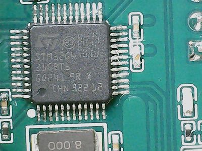

Hi @ABurc.2
Thank you for the time doing these tests, much appreciated.
Based on this experiment, PA15 is physically damaged, it could be an EOS or an extreme stress above our AMR (Absolute Maximum rating) current or voltage creating it. Do you have in your board or application another rail at 5volts, 12Volts or 24 Volts?
I never saw such behavior of fresh parts so far and it seems more a handling issue or accidental programming done somewhere.   It is quite impossible that such device is damaged, and we shipped it to any distributor   - we have basic tests factory of I/Os able to catch such issue called I/V curve on each individual pin and test at each MCU manufactured.

Here are the defective Microcontrollers:
 And here is the new one  we replaced  with
