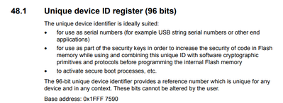

Thank you.  Here is my last question is possible to get with the CubeProgrammer the UID of the defective parts
it is at @ 0x1FFF7590:
This will allow us also to check at the defective MCU the tests at factory and then we may contact you back
Regards,
STOne-32.
