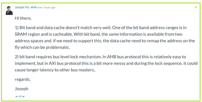

Indeed bit-banding is not available on Cortex-M7. According to ARM community from this post, the reason is the following:

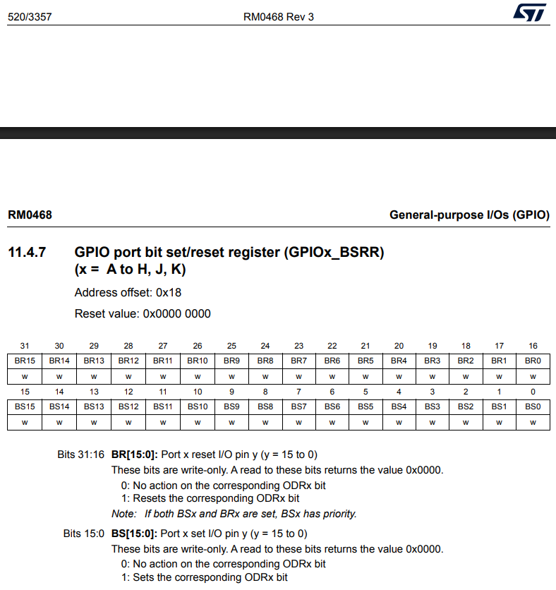

Check if your particular chip has a register (or registers) to give atomic bit manipulation; eg,
That's for STM32H723/733, STM32H725/735 and STM32H730:
https://www.st.com/resource/en/reference_manual/rm0468-stm32h723733-stm32h725735-and-stm32h730-value-line-advanced-armbased-32bit-mcus-stmicroelectronics.pdf#page=521

I showed the example of the BSRR register for GPIO ...

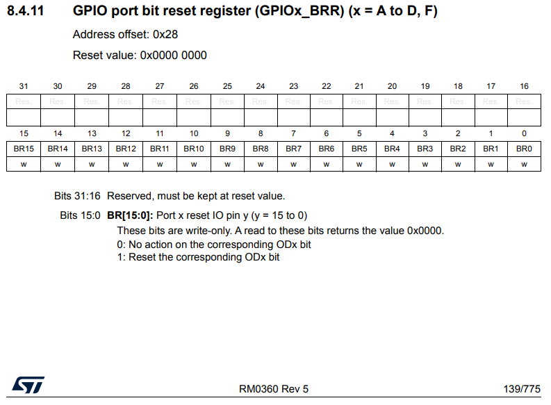

Some processors also have a BRR; eg, STM32F030:
https://www.st.com/resource/en/reference_manual/dm00091010-stm32f030x4x6x8xc-and-stm32f070x6xb-advanced-armbased-32bit-mcus-stmicroelectronics.pdf#page=139

Your question was about ARM bit banding and my answer was about that feature. Now if your question about GPIO pin you need to use BRR/BSRR registers to set/reset atomically a GPIO pin as described by @Andrew Neil .
GPIO->BSRR is ideal as it allows set/reset to occur at a singular clock edge, instead of the RMW which is going to take 8 or more cycles, and whatever the slower bus and write buffers add.

I guess the reason Bit-Banding has been abandoned is probably because there are (very?) few cases where it really brings any actual real-life benefits?
eg, see Bit-Banding in ARM Cortex-M: A Brilliant Feature… But why was it abandoned?
