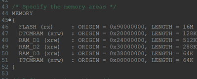

The below is the ld configuration
May I know if you can debug the application on the external flash? If you can, may I know if any other configurations need to be set?
Thanks.

I start debugging from my bootloader project(located in the internal flash) and ten jump to my real application located in the external flash memory. To do so I first program my external flash with the real application using STMCube Programmer and selecting the External Loader File. Therefore you need an External Loader script specifically written for your microcontroller and external flash to able to load your application into external flash.
After loading external flash (with the real application) I start a debug session on my internal application with the configuration given in my first reply. Please note that you only need to load the symbols of the external application.
Then in my FLASH.LD File of the internal application I define a region for external memory(which in my case is named as QUADSPI.
MEMORY
FLASH (rx) : ORIGIN = 0x08000000, LENGTH = 128K
DTCMRAM (xrw) : ORIGIN = 0x20000000, LENGTH = 128K
RAM_D1 (xrw) : ORIGIN = 0x24000000, LENGTH = 512K
RAM_D2 (xrw) : ORIGIN = 0x30000000, LENGTH = 288K
RAM_D3 (xrw) : ORIGIN = 0x38000000, LENGTH = 64K
ITCMRAM (xrw) : ORIGIN = 0x00000000, LENGTH = 64K
QUADSPI (xrw) : ORIGIN = 0x90000000, LENGTH = 16M
Please add the last line according to your memory size and start address.
Then starting from internal application I can jump to external application located in external flash.
