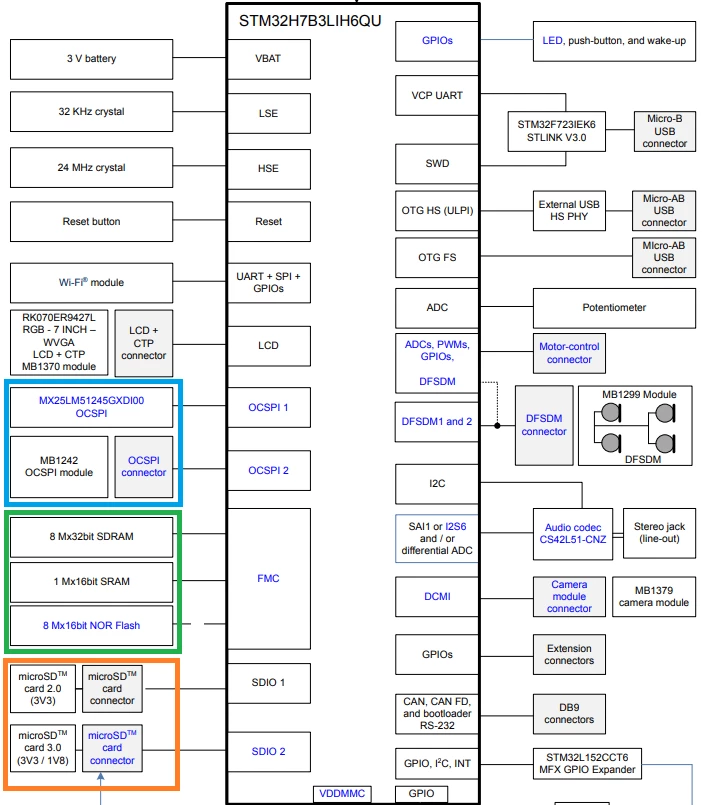

Regarding hardware, we use the STM32H7B3I-EVAL. We have several external memories (NOR flash, SDRAM, SRAM, microSD™ card) connected through OCTOSPI, FMC, and SDIO interfaces as illustrated in the figure below:
In this article, we mainly focus on the debugging in the OCTOSPI NOR flash memory (MX25LM51245GXDI00) connected to the OCTOSPI1 interface.

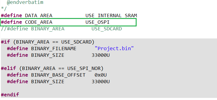

1.1. Configure the project “ExtMem_Boot” to load the application at the OCTOPI1 address
This project example is available in this directory below: STM32Cube_FW_H7_V1.11.1\Projects\STM32H7B3IEVAL\Applications\ExtMem_CodeExecution\ExtMem_Boot).
To use the OCTOSPI interface, do the following:
  • Open the ExtMem_Boot\Inc\memory.h file
  • Change the line #define CODE_AREA USE_NOR to #define CODE_AREA USE_OSPI (see the screenshot below)
As you can see, this project example allows users to define in which area they want to store data. It can be in external SRAM, external SDRAM, or internal SRAM. In our case, we store the data in the internal SRAM (#define DATA AREA USE_INTERNAL_SRAM).

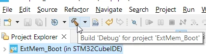

Finally, [Build] and [Run] the project “ExtMem_Boot

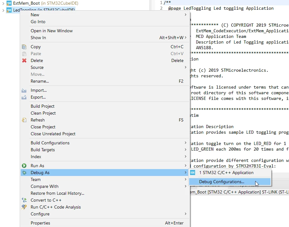

2.1. Configure the project “LedToggling” to debug in external memory
Right click on the project -> [Debug as] -> [Debug configurations…]

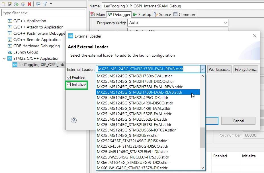

Pape_5-1722846532505.pngDouble-click on the [STM32 C/C++ Application] section, normally, you should have a debug configuration section named LedToggling XIP_OSPI_InternalSRAM_Debug”, click it and go to the [Debugger] section. At this step, we add the external loader related to the external memory (MX25LM51245GXDI00) connected to the OCTOSPI1 interface.
To do this, go to the [External loaders] section and click [Add] for the corresponding external loader.
In our case, we choose: MX25LM51245G_STM32H7B3I-EVAL-REVB.stldr (see the screenshot below).

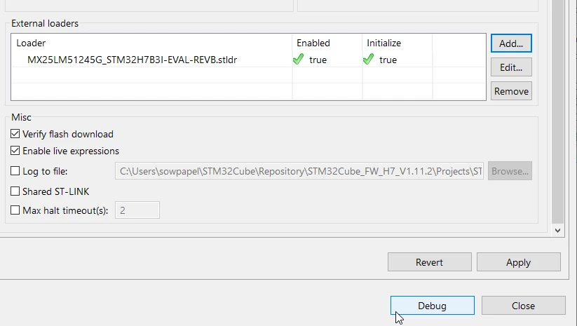

NOTE: Remember to check the [Initialize] checkbox as shown below. This permits automatic calls to the initialization function of the loader after the reset (see UM2609 for more information)
 At this step, you should have the setting below and then you have just to click on the [Debug] tab.
