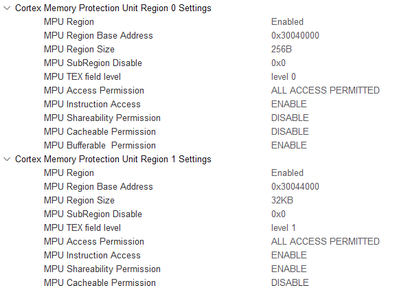

They are similar, with some slight differences with the MPU cache settings.
My first test is just basic ICMP - which doesn't work. That is, until I comment out this line:
SCB_EnableDCache();

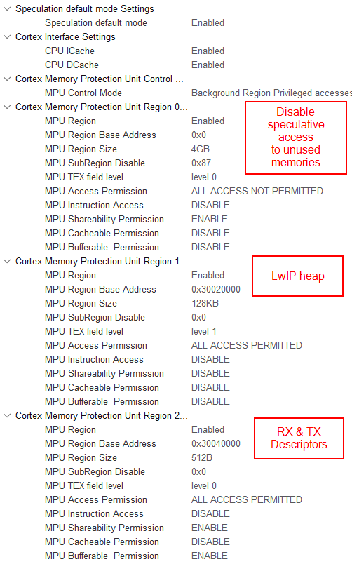

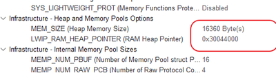

So, my settings looks like these:
LWIP settings:

2024-09-07 5:42 AM
Probably an issue in the LWIP heap memory region:
I suggest you to check again the MPU config (Bufferability, Sharability, Cachability and TEX level) as described in https://community.st.com/s/article/How-to-create-project-for-STM32H7-with-Ethernet-and-LwIP-stack-working?t=1679361727348:
