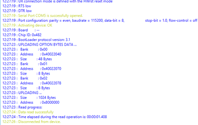

at first I tried to program the microcontroller by connecting the uart1  RX/TX directly with a usb converter to the pc. and it was successful. below you can see the programing process .

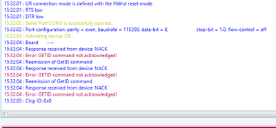

for the next step I connected the bluetooth Module to my microcontroller and try to do it again but I faced a problem .

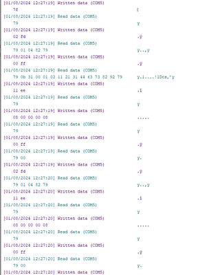

so I decided to monitor the serial port to see what happened .

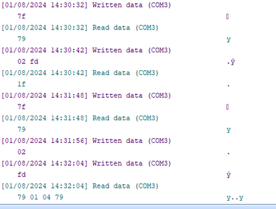

in the normal situation the serial monitor is like this

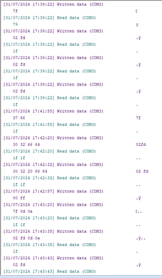

but when I use the bluetooth module it will be so:
so I realised that the problem starts from the second command(02 fd).
I tried to send the commands with a serial port to the MCU but when I send the command "02  fd" it will return 1f to me and that is wrong.
as I know from the aplication note an3155 that this line contins two different commands , I have done it in another way so that: at first I send the command "02" and with a small delay send "fd" then it works well . you can see also the results below
