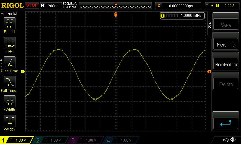

The DAC does output a reasonable 1 MHz sinewave. It isn't a pretty one as it is constructed by just 7 samples from the sinewave-table.
‎2019-09-24 9:08 AM
See the image I uploaded. I don't think the DAC is overclocked. The datasheet states "Max frequency for a correct DAC_OUT change when small variation in the input code (from code i to i+1LSB)" So I cannot complain with ST when the output isn't correct anymore.
The load of the DAC is 0 (zero) ohm as it is connected directly to the negative input of the (external) opamp with the positive input on (virtual) ground. Therefore there is no problem with any capacitive loading. (see AN4566)

Timer-triggered mode does help. I now use TIM8_UP to trigger DMA2 and I can almost get it to work at 9 MHz, so now I have settled for 8 MHz. Thanks for the suggestion, I wouldn't have thought about doing it this way. One question though, why does this give some jitter?
Wilko
‎2019-09-25 3:55 AM
Beacuse of the collisions with other busmasters, and potentially collisions within the DMA module itself.
If you can ensure that neither processor core nor other DMA nor other busmaster accesses the memory you are using as data source nor the the APB1 bus, this might perhaps be jitter-free.
