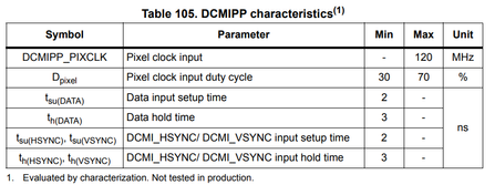

I'm looking to interface a dual channel 12bits ADC (TI ADS4222) with an STM32N647L0.
Using a 58MHz sampling clock, I will generate two 58MSPS data streams feeding into my STM32. The acquisitions will be short, so the raw data will be around 1 MB per channel.

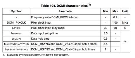

I'm wondering whether I can use both the DCMI and DCMIPP interfaces simultaneously to handle the two ADC channels and feed the NPU.
Has anyone already tried this? What is the maximum pixel clock for each interface? I'm not sure which application note applies to these devices.

The STM32N647L0 supports dual camera inputs by using the DCMIPP as the main interface and optionally DCMI for a second camera.
as mentioned in the STM32N6 reference manual RM0468 section 37.5.6 Double sensors:
Two sensors are simultaneously and independently supported with the following restriction:
• One sensor must be low-resolution, so that it can use the DCMI (the other sensor uses the DCMIPP).
• Two input interfaces must be available: one sensor is CSI2, and the other parallel.
The maximum DCMI pixel clock = 100 MHz and the maximum DCMIPP pixel clock is 120 MHz as mentioned in the datasheet Table 104 and Table 105.
