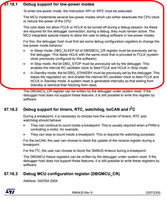

@SD0509 wrote:
 I have enabled the debug in low power modes.
Then the low power modes are not really low power at all!
@SD0509 wrote:
But that doesn't justify a power consumption of 7mA in stop modes
Oh yes it does - It explains it entirely!
Addendum - from the Reference Manual:
waclawek.jan
Whoa there. It may be *one* of the explanation - others brought up valid points, too.
