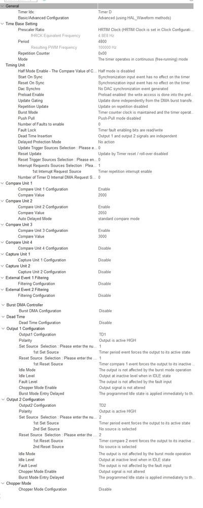

I cant make work the HRTIM. I am using the weact board.
I tried HRTIM-A and TRTIM-D using the cubeide (latest updated). the first one using "basic HAL" and the second using "Advanced Hal" instructions
TIM5 works so it seems that clock is working.
I added following code to make run the timers and the debugger passed them without trouble:
  MX_HRTIM_Init();
  if(  HAL_HRTIM_WaveformOutputStart(&hhrtim, HRTIM_OUTPUT_TD1)!= HAL_OK)
		Error_Handler();
  if (HAL_HRTIM_WaveformOutputStart(&hhrtim, HRTIM_OUTPUT_TD2)!= HAL_OK)
		Error_Handler();
  if (HAL_HRTIM_WaveformCountStart_IT(&hhrtim, HRTIM_TIMERID_TIMER_D)!= HAL_OK)
		Error_Handler();
  if (HAL_HRTIM_WaveformCounterStart(&hhrtim, HRTIM_TIMERID_TIMER_D)!= HAL_OK)
		Error_Handler();
  if (  HAL_HRTIM_WaveformSetOutputLevel(&hhrtim,
                                   HRTIM_TIMERINDEX_TIMER_D,
                                   HRTIM_OUTPUT_TD1,
                                   HRTIM_OUTPUTLEVEL_ACTIVE)!=HAL_OK)
	Error_Handler();
                                   HRTIM_OUTPUT_TD2,
		Error_Handler();
		Error_Handler();
  if (HAL_HRTIM_WaveformCounterStart(&hhrtim, HRTIM_TIMERID_TIMER_A)!= HAL_OK)
		Error_Handler();
                                   HRTIM_TIMERINDEX_TIMER_A,
                                   HRTIM_OUTPUT_TA1,
	Error_Handler();
                                   HRTIM_OUTPUT_TA2,
		Error_Handler();

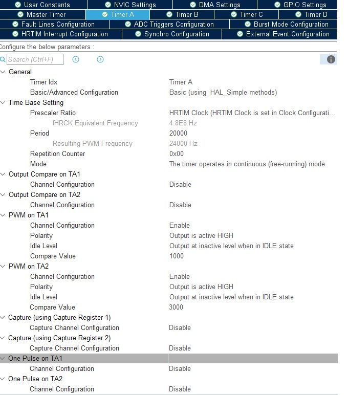

Here are the configurations of the cubeide:
TIMER-D configuration:
TIMER-A configuration:
MASTER TIMER CONFIGURATION:
JLope.11
After making this:
HAL_HRTIM_WaveformOutputStart(&hhrtim1, HRTIM_OUTPUT_TA1);
HAL_HRTIM_WaveformOutputStart(&hhrtim1, HRTIM_OUTPUT_TA2);
HAL_HRTIM_WaveformCounterStart(&hhrtim1, HRTIM_TIMERID_TIMER_A) ;
  HAL_HRTIM_WaveformSetOutputLevel(&hhrtim1,
                                   HRTIM_OUTPUT_TA1,
                                   HRTIM_OUTPUTLEVEL_ACTIVE);
                                   HRTIM_OUTPUT_TA2,
 Worked the Timer A1 but not the A2, that is due Weact board uses  the HRTIM legs to connect to USB ,camera, display. I recommend build a custom board.
