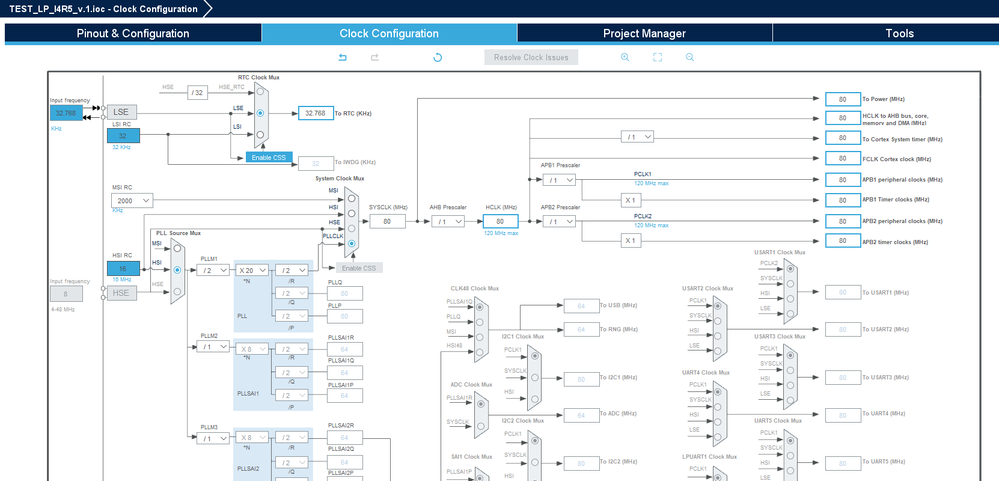

Here's my clock configuration:
and this is my code snippet:
void PreSleepProcessing(uint32_t ulExpectedIdleTime) { /* Called by the kernel before it places the MCU into a sleep mode because configPRE_SLEEP_PROCESSING() is #defined to PreSleepProcessing(). NOTE: Additional actions can be taken here to get the power consumption even lower. For example, peripherals can be turned off here, and then back on again in the post sleep processing function. For maximum power saving ensure all unused pins are in their lowest power state. */ HAL_DBGMCU_DisableDBGStopMode(); LP_GPIO_Init(); HAL_SuspendTick(); HAL_RTCEx_SetWakeUpTimer_IT(&hrtc, 0x500B, RTC_WAKEUPCLOCK_RTCCLK_DIV16); //STOP2 MODE HAL_PWREx_EnterSTOP2Mode(PWR_SLEEPENTRY_WFI); }
void PostSleepProcessing(uint32_t ulExpectedIdleTime) { /* Called by the kernel when the MCU exits a sleep mode because configPOST_SLEEP_PROCESSING is #defined to PostSleepProcessing(). */ /* WAKE UP WITH RTC */ HAL_RTCEx_DeactivateWakeUpTimer(&hrtc); MX_GPIO_Init(); HAL_ResumeTick(); SystemClock_Config(); }

@SD0509 wrote:
I'm still puzzled by this value that differs from what is indicated in the datasheet.
Again, the datasheet covers just the chip itself - it cannot take anything outside the chip into account.
It also knows nothing of your application.
