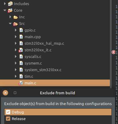

CubeIDE doesn't look for C++ files. Even worst, no matter that the main.c file has been marked for being excluded from the building, the tool always uses it.
Although I started the project as a C++ one, the tool didn't generate the corresponding main.cpp file, so I did it by hand.
Even worst (yes, things can get ugly pretty quickly) the IOC tool removes silently the "don't compile the main.c file because it's a C++ project" flag.
What can I do?
From the image below please note that the main.c file has been excluded but the compiler (right pane) is compiling it anyway. Also note that the file main.cpp isn't compiled. The functions MainApp() and Tick_IRQUserCallback() are located inside this file:

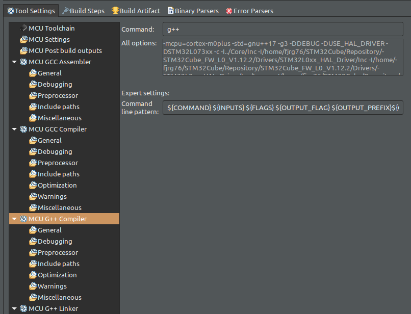

‎2024-03-19 1:23 PM
Hi!
"CubeMX is set up to generate main.c. There is no changing that. C++ projects can have C files in them, it is typically unavoidable."
I understand that, however having two main files is why I don't get it.
"Right click your project and convert it to C++.
Ensure the Tool Settings tab shows a C++ compiler step."
The project already includes the C++ compiler step, but it refuses somehow to compile my .cpp files:
"Exclude from Build is configuration-specific. Ensure it's marked for the configuration you're building."
I've excluded main.c from all my configurations, yet it gets compiled:

‎2024-03-19 3:13 PM - edited ‎2024-03-19 3:15 PM
Please do as advised by TDK: "Right click your project and convert it to C++.
The main file is where the main() function is. There should be only one file with base name "main", because of Eclipse CDT build system. So there should be no main.cpp.
Right click on the project in the project manager view in Eclipse, click Refresh (F5). Now you are all set.
