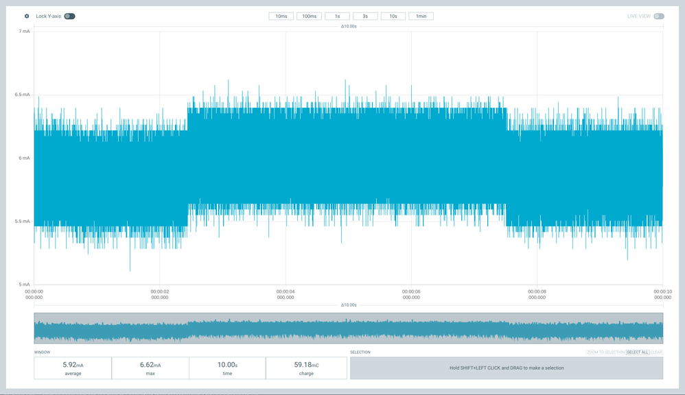

I’m trying to get the STM32WB55CGU6 into STOP2 mode, but I consistently see current consumption over 600 µA, both on my custom PCB and on the WeActStudio.STM32WB55CoreBoard. I’ve been stuck here for days and can’t make progress with my project because of this.
Here’s what I’ve done so far:
  • Thoroughly studied AN5071 and AN5289.
  • Read several community posts and blogs from users with similar problems.
  • Ported the official examples PWR_STOP2_RTC and PWR_EnterStopMode to my MCU.
  • Verified that the project builds correctly and behaves as expected, except for the power consumption.
Despite following all the steps I could find, the current remains way too high. I would expect it to be in the range of a few microamps.
Here’s a screenshot from my PPK2 measurements:
(I would expect that when LED is off, the STOP2 mode would be much more evident in terms of consumption)

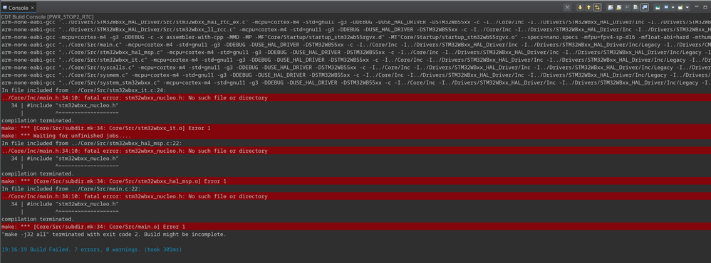

I tried importing P-NUCLEO-WB55.Nucleo/Examples/PWR/PWR_STOP2_RTC example into CubeIDE directly but it messes up compeltly entire file system creating new directories like Core:
So instead spending time fixing those errors (unresolved dependencies, implicit declarations, undeclared stuff...), I started from scratch. Also, the example is prepared for the RGV6 package and mine is CGU6.
I have not any Nucleo boards, just some custom PCBs and WeAct I mentioned earlier.
FilipKremen
it should work even though the packages are different.
Please try to add the file (stm32wbxx_nucleo.h) from STM32Cube\Repository\STM32Cube_FW_WB_V1.22.1\Drivers\BSP\P-NUCLEO-WB55.Nucleo to the project or you can try to download the package again.

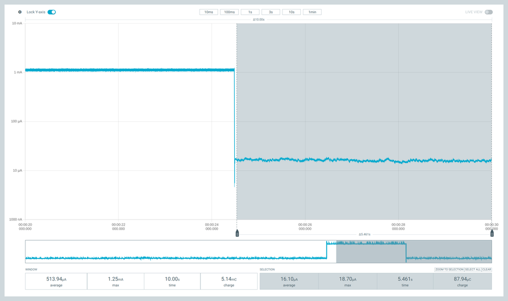

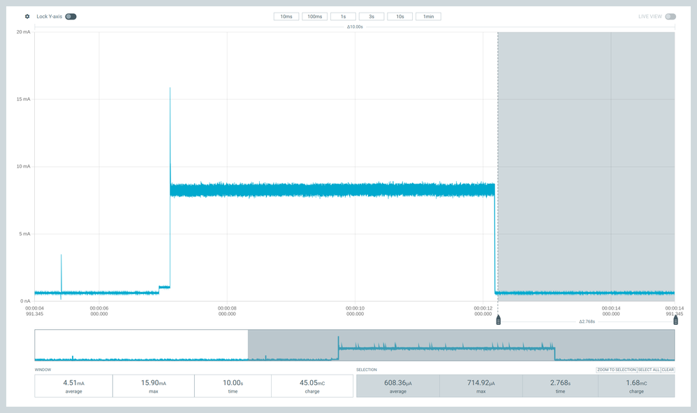

r3v1
Thanks for the suggestion,
I copied the BSP and works in a newly created PWR_STOP2_RTC project, now I can see the cosumption has been reduced to ~600uA in the WeAct board:
And to ~16uA in my custom board!!
Just to recap, should I avoid the code generated by CubeIDE and go with the BSP? Or what are the main differences between the original Nucleo PWR_STOP2_RTC project code and the one generated by CubeIDE? It seems a bit *** to me to have the same code, but only work with the Nucleo headers and the RGV6 RAM and boot files? could it be that the CGU6 files have some bug?
