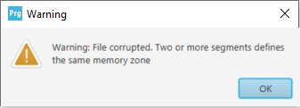

Thank you for your ELF file @42Bastian Schick , I flashed it and get this error :
  • Can you please check your linker file ? That might be a memory zone definition overlap...

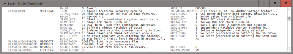

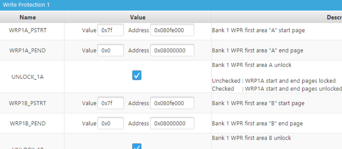

  • Also what are your OB configuration ? (RDP level? User config? and Write Protection with page size?)
Best Regards,
Pierre
42Bastian Schick
Yes there are memory regions with the same start address, but of size 0. So you can ignore the warning.
OB:
I hope above makes sense. CubeProgrammer does not allow to "dump" the OB info nicely :(
WRP2 same, only 0x081...
