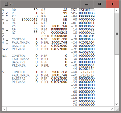

Ok, it is getting complicated. Here more pictures.

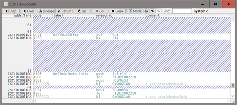

Anyway, at HelloSciopta you have this:
In my test, I set a breakpoint 0xC0021E8, registers/stack:

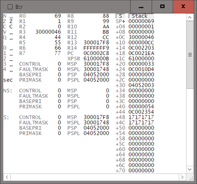

Single step "svc" instruction, new registers:
As you see, R13 is reduced by 0x20, r0-r3 ... stored to the stack.

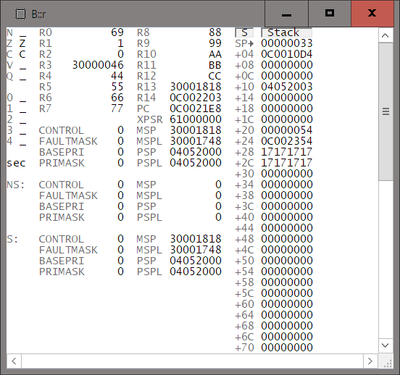

Now restart to breakpoint. Change CONTROL to 1 (via Debugger) and singlestep:
Again, r13 is reduced by 0x20, but the stack contents was not modified.
Regarding security settings: These are identical for both use cases and I cannot find a single hint, that would explain why there is no content written.

I had exactly the same problem.
In my case it works now. The default settings in the SRAM3 GTZC1_MPCBB3_PRIVCFGRx configuration registers allow only privileged access (with enabled TrustZone). After setting these configuration registers to 0 it works.

I think this is STM32U5 specific. ST adds "Resource isolation improvements" on top of the ARMv8-M TrustZone. These improvements allow a block-based secure and privilege configuration for internal SRAM.
See page 8 on the STM32U5-Security-Overview (SECOVW) presentation.
‎2023-10-10 8:42 AM - edited ‎2023-10-10 8:43 AM
I guess that is it. From the STM32U5 manual
5.4.2
* llegal unprivileged access
Any unprivileged transaction trying to access a privileged resource is considered as
illegal. There is no illegal access event generated for illegal read and write access. The
addressed resource follows a silent-fail behavior, returning all zero data for read and
ignoring any write. No bus error is generated. A bus error is generated when any
unprivileged execute transaction tries to access a privileged memory.
