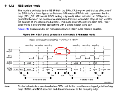

‎2025-01-07 6:09 PM
Maybe I don't understand the SPI protocol well. How would the slave know where a frame/word ends and the next one begins?
‎2025-01-07 9:00 PM
Typically that's done with a separate chip select (CS) line. You can use NSS Pulse mode to have the CS line go high between words, if that's what you need.
‎2025-01-07 9:26 PM
Here's my Data in yellow, NSS in blue.

‎2025-01-08 3:44 AM
Hi SoCal,
Having a look at your file 2.png, NSS is definitely not right. Whats the scale of the NSS trace? It looks like a signal with a bit of ground bounce (very low voltage) - every time your data changes, you get a bounce on NSS. Its certainly not indicating end of word.
Whats the voltage of the ringing on NSS?
Regards,
Toneski
‎2025-01-08 7:38 AM
Seems okay to me, except there's a lot of cross-talk/bounce. You're only showing about 8 bits worth of data, so could just be missing where the pulse is. Did you enable NSS Pulse mode? Can you show your code?
