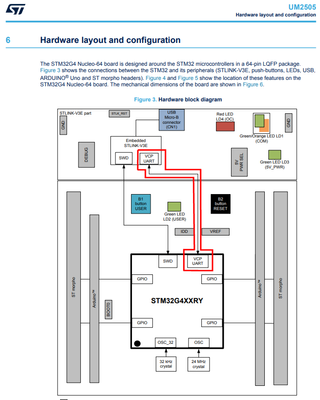

I need to communicate from a PC to the STM32 over USB.  Am I correct in assuming that the CN1 USB connector is only available for ST-LINK, and I need to attach a second USB connector with breakout pins onto the Morpho connector?
Is there a brief description somewhere of which USB lines go to which Morpho pins?

Right, you need to add a board with a USB connector. See the manual for your Nucleo board and the STM32G474 datasheet for Nucleo pin connections and G474 pin functions respectively.
The latest Nucleo-64 boards (with H5 and U5 series), finally add the long-awaited USB connector.
What kind of communication do you need?
The ST-Link on the board also provides a Virtual COM Port (VCP);  that allows you to communicate from a PC to the STM32's UART over USB - see Fig 3 in the User Manual:
See also section 6.6.5

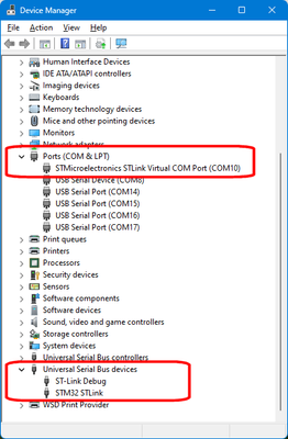

Thanks for the pointers!  But I can't figure out how to tell the STLink to enable its VCP.  Is there a document that shows me how to configure the IOC file in STM32CubeIDE?

If you've started a new "board" project then the VCP is already enabled. If you want interrupt, you have to enable the NVIC.

- Did you install the driver STSW-LINK009? Try installing/updating the ST-Link firmware version through this link STSW-LINK009.
