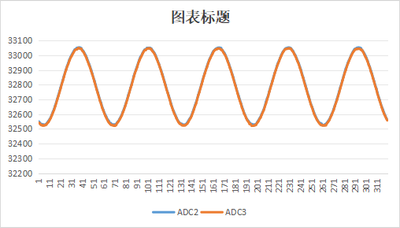

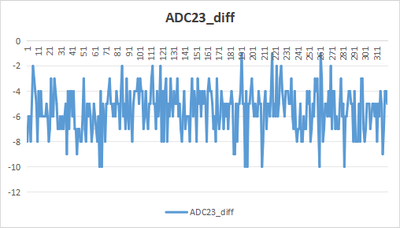

I just want to verify the consistency of the three ADCs to improve the reliability of the system. Based on the current test results, there are no abnormalities in the original sampling data. Does this indicate that the proposed solution is feasible?The result is as follow.
‎2024-12-09 6:34 AM
Results are too good to be real, deep fake?
what uCPU board is in test?
‎2024-12-09 5:24 PM
The result was actually tested and has been consistent multiple times. We are using a board that we have designed ourselves.
