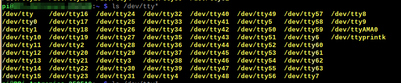

OK, I just dug out an RPi and Nucleo board, and tried it.
Before plugging-in the Nucleo board:

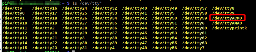

After plugging-in the Nucleo board, I get the pop-up for the MSC:
and there is a new /dev/ttyACM0:
@suhfi so here,  the /dev/ttyACM0 is the ST-Link's Virtual COM Port on the Raspberry Pi;  you use it just as you would use any other "COM port" (ie, /dev/tty... device) on a Linux system - there is nothing special or specific to STM32 as far as Linux & the Raspberri Pi are concerned.
The actual /dev/tty... device assigned may be different - just like you get different COMxx: numbers in Windows - so use the above method to discover what device is created on your particular system.

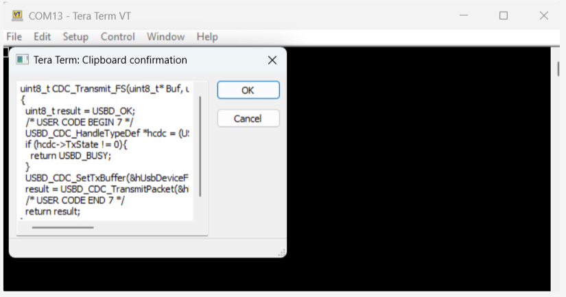

@suhfi wrote:
That's on Windows - not a Raspberry Pi !
And the code you've shown is trying to use the USB peripheral within stm32f411re the chip - not the UART that's connected to the ST-Link's VCP.
PS:
And pasting that code into TeraTerm's clipboard won't do anything useful at all !!
As I expected it needs to be automatically detected on Linux. I thought it would be named ttyUSB.
Glad to know that!

I added a 2nd Nucleo board, and it appeared as  /dev/ttyACM1
An FTDI cable gets  /dev/ttyUSB0

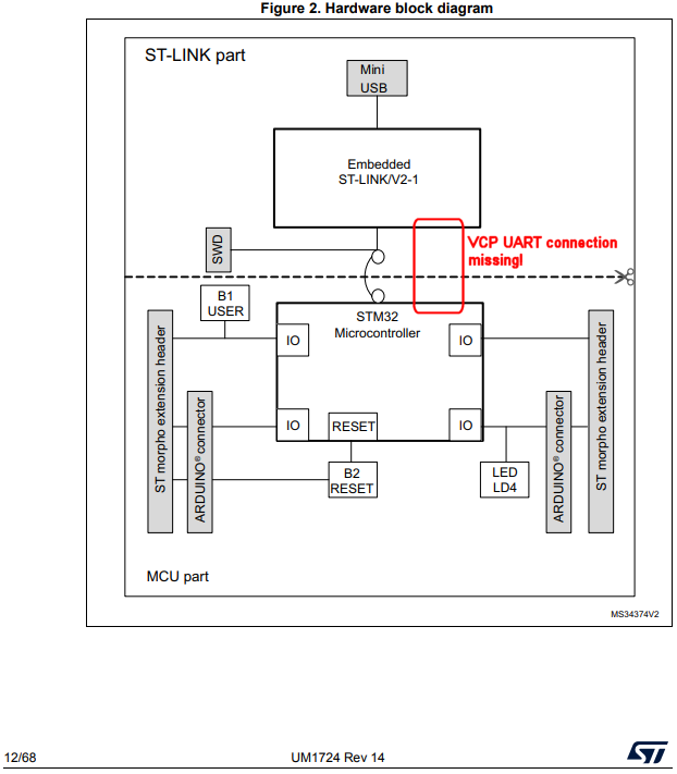

The CN1 connector on the Nucleo-F411RE board connects only to the ST-Link - it does not connect to the stm32f411re microcontroller chip.
The ST-Link's VCP is connected to USART2 of the stm32f411re microcontroller chip:
Therefore, if you want to communicate via the ST-Link's VCP, you need to use USART2 of the stm32f411re microcontroller chip.
You do not use the USB within the stm32f411re microcontroller chip.
PS:
The current User Manual for the Nucleo board is unhelpful in that it doesn't clearly show the VCP connection:
This has been reported to ST, but not yet corrected:
https://community.st.com/t5/stm32-mcus-boards-and-hardware/nucleo-user-manuals-don-t-show-the-vcp-uart-connection/m-p/644959/highlight/true#M17438
