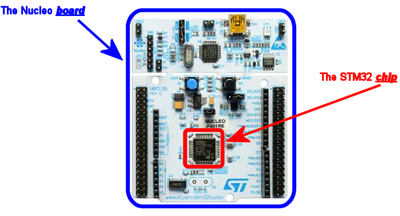

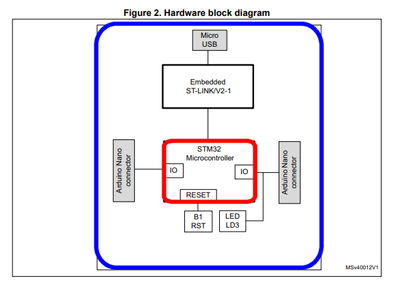

These are chips:
So are you talking about a Nucleo-F411RE board ?
https://www.st.com/en/evaluation-tools/nucleo-f411re.html
To clarify, the chip is highlighted in red; the board in blue:
https://community.st.com/t5/stm32-mcus-boards-and-hardware/nucleo-stm32f303k8-pa3-pin-doesn-t-work-for-uart-receive/m-p/690491/highlight/true#M19880
