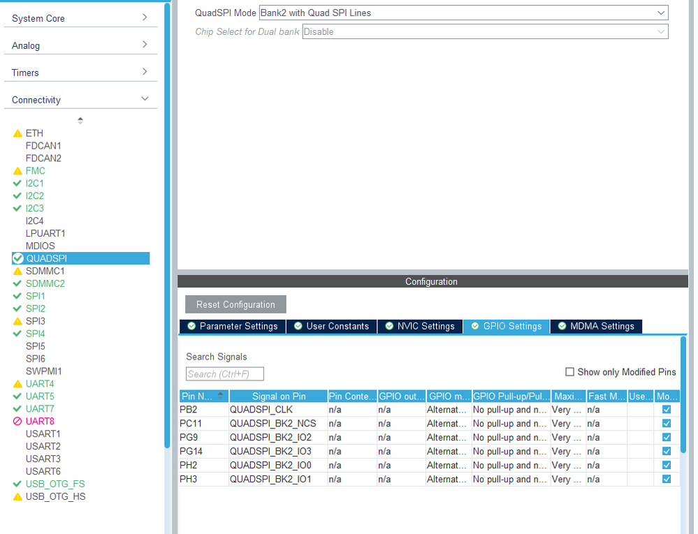

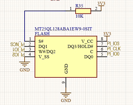

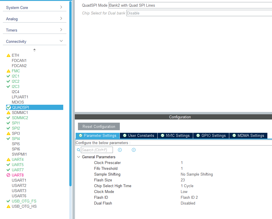

I have working project with MT25QL128ABA running at 120 Mhz on the same STM ( STM32H743) chip
It can run up to 133 Mhz
there is nothing called synchronous mode in the setup. you do not need this.

Its a clocked bus, so I don't know what kind of "asynchronous" method you're imagining?
NAND will not Execute-In-Place
Need to pay a lot of attention to the traces/routing to hit very high-speed.
The CM7 caches, so you can hide a lot of the latency and slowness as execution generally jumps around.
There's a very large selection of Quad SPI NOR and NAND Flash. Decide what you want to do.
Would recommend using a SOIC16W foot-print for broadest number of options, perhaps a rotated SOIC8 within.
BGA24 is also an option for newer/larger parts, might depend on your board costs and PCBA preferences.
