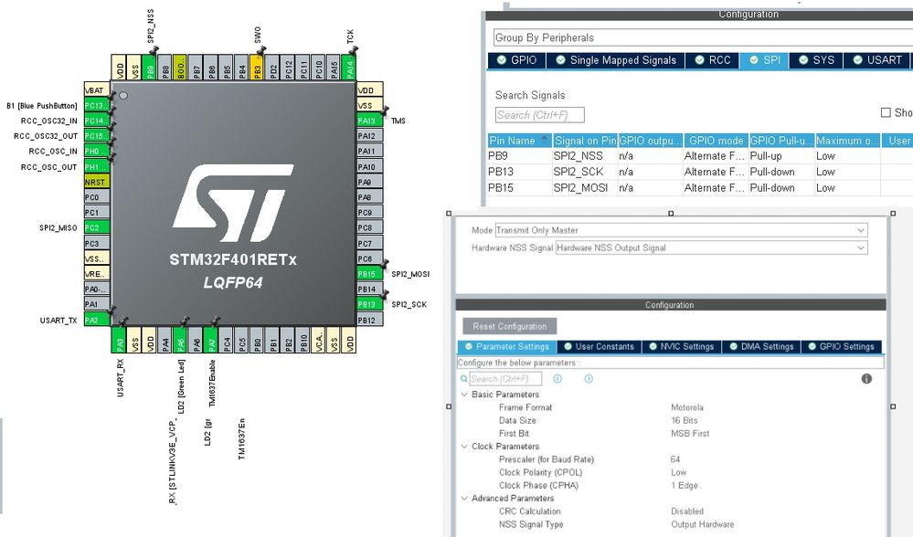

I m having an issue with my Nucleo F401RE. I m porting a code based on the use of SPI2 that worked very well on Nucleo G431RB. I made same setting on Nucleo IDE (see picture).

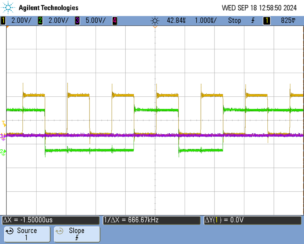

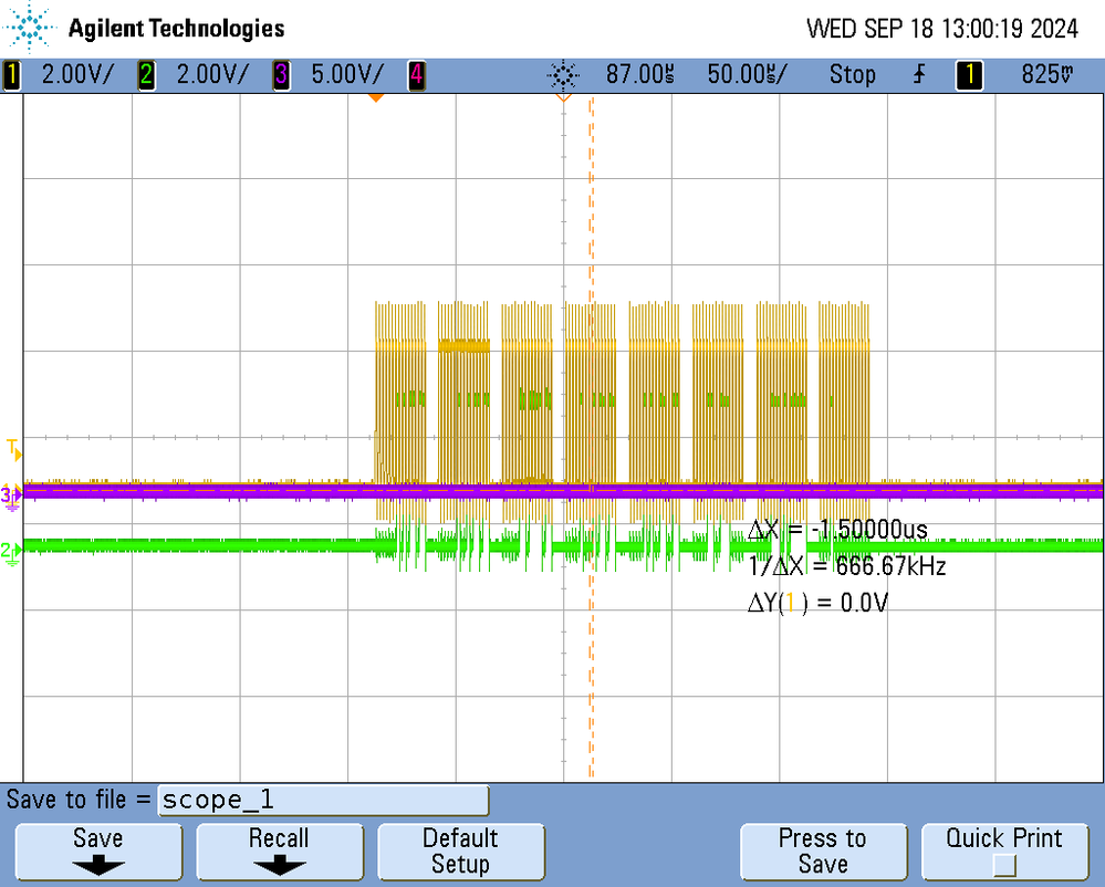

Then the NSS goes down and stucked there forever. In the picture (yellow is clk, green is data out, and violet is nss).

Don't use the hardware NSS pin on the STM32F4, it's not driven like a CS pin. It will always be low when the peripheral is active. Instead, initialize it as a GPIO output and manually set it low before transmission, and high afterwards.

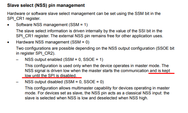

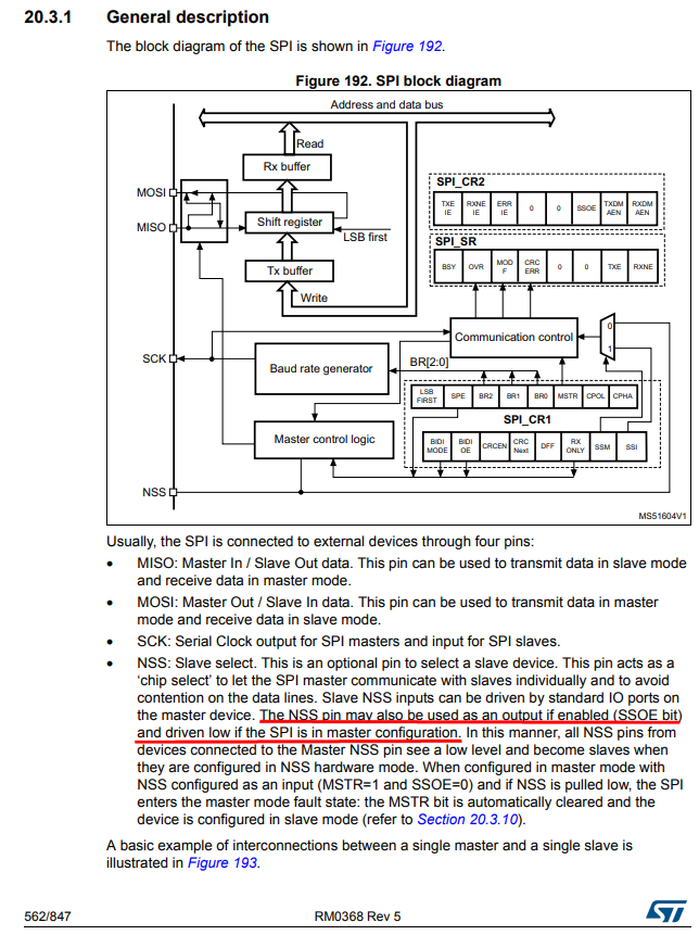

The behaviour of the  "hardware NSS output signal" is described in the Reference Manual:
https://www.st.com/resource/en/reference_manual/rm0368-stm32f401xbc-and-stm32f401xde-advanced-armbased-32bit-mcus-stmicroelectronics.pdf#page=562
Indeed, that doesn't sound like a very useful behaviour - but it is the defined behaviour.
https://www.st.com/resource/en/reference_manual/rm0368-stm32f401xbc-and-stm32f401xde-advanced-armbased-32bit-mcus-stmicroelectronics.pdf#page=563
Unfortunally it doesn t work as described in the Reference Manual. I have to add manual CS meaning that I have to add layer of software (simple modification) over the HAL.

That is the behaviour described in the UM:
So, if you want it to release NSS (from the low state), you need to disable the SPI.
