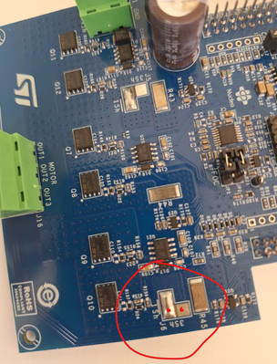

I'm looking at a diagram of the X-NUCLEO-IHM08M1 and the manual states that you can select either 1 shunt or 3 shunts using jumpers J5 and J6.
By default, there is one shunt, but when tested with a multimeter, there is continuity between the two red points in the photo:
With the multimeter, I should be getting a reading of 10 MΩ on the tin, right? And between the tin and the other plate?

At a glance through the schematics of the X-NUCLEO-IHM08M1, you will find on J6 (similar for J5) the two signals Vshunt_2 and Vshunt_3, each of which leads to a shunt with 10mΩ. All of these shunts are connected to GND, so you should measure 20mΩ between the signals - which ordinary multimeters usually cannot distinguish.
Hope that helps?
Regards
/Peter
Did you mean MΩ - or mΩ  ?
