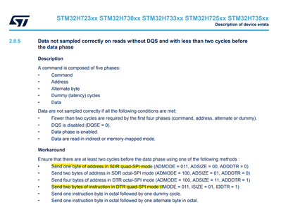

Hello @Aries16;
Are you reading the manufacturer device ID with less than two cycles before the data?
Please look at the errata sheet:
I think the "sCommand.InstructionSize" is missing in your code.
Thank you.
