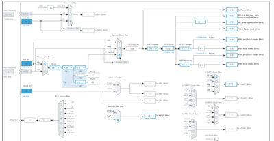

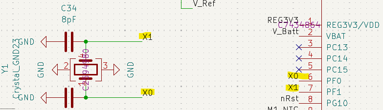

Hello, I have a custom board wich is based on the evspin32g4-dual Board. I generated the code with motorcontrol work bench and could upload it with a j-link. I added an uart output in the startup and noticed that it kept printing it, so the board was constantly resetting. When I stepped through the code the problem was in HAL_Delay, as the HAL_GetTick() function always returned the same value, thus not leaving the function. Could there be an error with the external Crystal? I am using a ECS-240-8-37-CKM-TR with 8pF caps.
Thanks!

The HAL_GetTick() function relies on the SysTick timer, which in turn depends on a stable clock source, so yes, probably it's an issue with the crystal.
You can refer to AN2867 for oscillator design guidelines.

I would try to verify this by building a version using the internal oscillator (HSI).
Check the PLL settings to get the same system clock rate as with the HSE.
QuirinS
Thanks for your reply, I just checked the project and HSI is already in use.
If the code is running, it's not likely a crystal problem.
Probably you're calling HAL_Delay in an interrupt context, or with interrupts disabled.
Set SysTick priority to 0 and everything else above that.

I checked the reset cause and the RCC_FLAG_PINRST was set, i disabled the reset pin by setting the nrst_mode = 2 with cube programmer but its still the same problem
Do you start a watch dog timer? Have one on your board?
Otherwise constantly resetting is more likely a hardware/board level issue.
Perhaps scope NRST/NRESET pin check if it is periodic, and what that period is.
Check supply isn't browning out
Check VCAP pins if present, should have around 4u7 F total on them, and 1.25 V
