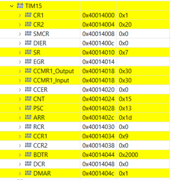

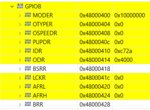

Read out and check/post content of TIM and relevant GPIO registers.
timer registers at said breakpoint in original post and GPIO (PB14 is signal I am monitoring)....this is after a reset and the 1st time hitting the breakpoint

I was hoping you were going to decipher the registers, thus find out what's wrong, yourself.
GPIOB_MODER=0x10000000
that means, the field for PB14 is set to 0b01, i.e. GPIO Output, not AF (which would be 0b10).
And AFR for PB14 is set to 0, for TIM15_CH1 it would need to be set to 1 (see Alternate functions table in DS).
In other words, you don't have PB14 set as TIM15_CH1 at all.
But even if you would have PB14 set as AF/TIM15_CH1, as both TIM15_CCER.CC1E = 0 and TIM15_BDTR.MOE = 0, that output would be disabled anyway.

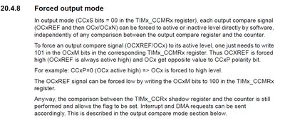

The manual clearly states:
I have tried CCxP both high and low in conjunction with using "FORCE INACTIVE" and "FORCE ACTIVE" but none of the combinations seem to work.

> To me they all looked fine plus the scope is showing me that the I/O is performing to the "toggle on match" as expected.
Not with these settings.
You have PB14 set as GPIO Out, and set to 1 in GPIOB_ODR.
If I change GPIO->MODER to AF my signal (yellow scope trace) completely disappears.  That is not what I want.  I am bound to pin PB14 so I cannot change CCR1 in CubeMX to "Output Compare Ch1" which then forces me to use GPIO and generate an Interrupt on match. Here is a scope picture (both micro and macro) showing the issue:
