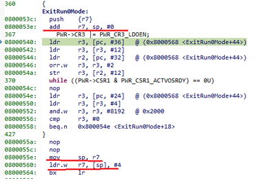

The bl instruction places the return address in the lr register. If ExitRun0Mode is a leaf function (does not call other functions), there is no need for the compiler to save lr on the stack, but just to generate a bx lr instruction for return. The current implementation is indeed a leaf function that just sets PWR->CR3 and waits for the PWR_CSR1_ACTVOSRDY condition. No need to touch the stack.
But, interestingly, when compiled in Debug configuration (-O0 optimization), it will use the stack for saving r7 (callers frame pointer):

This is pointless as the caller is the startup code that does not use r7 at that time.

No no surprise, but it looks like you found a bug.
I don't know the internals, but the cited RM explicitely forbids such access.
Maybe @mƎALLEm can help here.
As a quick workaround, you may add #pragma GCC optimize("O3") to the source code.

@Torsten_Robitzki your interpretation is correct. That's why ExitRun0Mode() has been introduced and implemented, I think starting from the CubeH7 package V1.7.0 (if I'm not mistaken).
@KnarfB that's and interesting finding. When in level -O3, do you have the access to the stack?
@Saket_Om : could you please check? at this stage the RAM memory should not be accessible.
-Os -O1 and better are fine:

 But there is no guarantee for future/alternate toolchains.

Hi @KnarfB ,
I may found a solution to that unwanted access to the stack by replacing:
void ExitRun0Mode(void)
by
void __attribute__((naked)) ExitRun0Mode(void)
But this is applicable only for GCC.
With the "naked" attribute: no SP is called:
without "naked" attribute: SP is called:
Could you test from your side?
