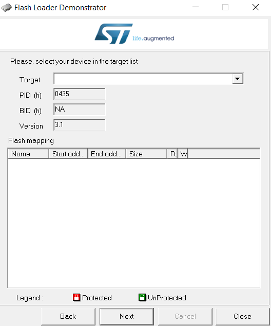

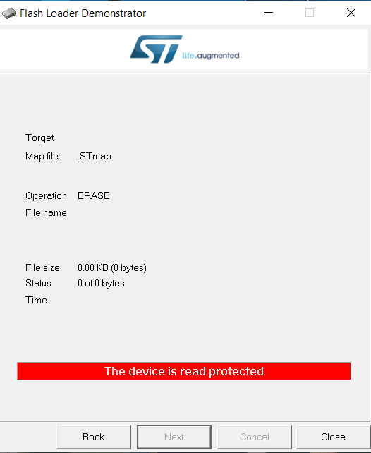

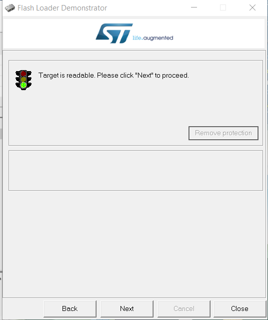

Finally after a long struggle, I was able to get into the system memory by changing to CP2102 ttl wire. Now I have another problem. Any solution to fix this?
The PCROP_PDP bit is unchecked also.
mƎALLEm
The tool you are using is very old and obsolete. Please use STM32CubeProgrammer  instead.
Refer also to this article on how to use the tool in bootloader mode with an example:
https://community.st.com/t5/stm32-mcus/how-to-use-stm32cubeprogrammer-to-access-the-usart-bootloader-on/ta-p/49608
Hope it helps.
