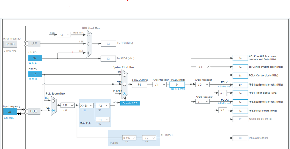

@Community member​ for example my clock speed is 84Mhz , according to the formula if i want a timer count of 1 second i would need values as PSC = 10000 and ARR =8400 , yet when i insert these values i get a timer of 8.4 seconds ? , but then I inserted values ARR = 10000-1 and PSC = 1000 i get 1 second exact .
‎2022-05-15 12:27 AM
That means that TIM1 clock is not 84MHz as you thought. You can verify it by outputting system clock onto the MCO pin and measure using oscilloscope/logic analyzer.
Check RCC registers content, and frequency of the primary clock source. Try with HSI first, its frequency is known.
‎2022-05-15 1:02 AM
Yeah I had my doubts , but I scratched it out beacuse how can CubeMx get the clock wrong ? Never really checked clock before using MCO pin so yeah , thats a another problem on another thread . So My clock is basically running on 10Mhz ??
‎2022-05-15 1:25 AM
Read out and check RCC registers settings. Check the primary clock (i.e. do you have a 25MHz crystal connected?)
‎2022-05-15 1:31 AM
yes, the 25Mhz crystal is connected and I am using HSE as my clock source ,both in pinnout and clock configuration block, otherwise if connection is issue i shouldnt be getting any clock ? . My clock settings are as show below . Also on the top i've shown my actual CubeMx clock configuration ,which matches exactly with the code generated i believe .
