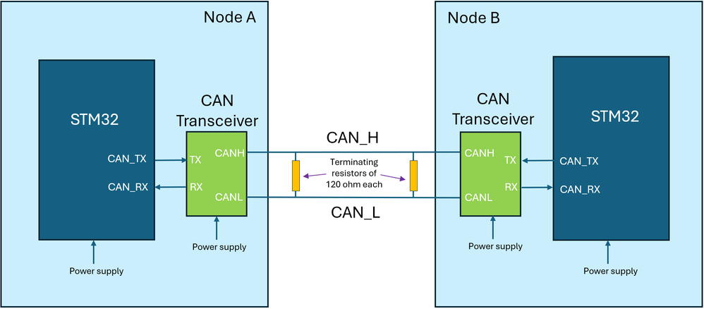

You cannot use CAN in Normal mode without establishing a complete CAN bus i.e. at least two CAN nodes as shown in the following figure:
CAN is not UART or SPI so you can simply run a  transmit program and watch what happening on Tx pin!
CAN has an acknowledgement mechanism that needs to the receiver to send an acknowledgement bit to the sender so the latter knows that the frame received well. That's why the Loopback mode is there to test CAN without a CAN bus. In the loopback mode, the acknowledgement is sent internally.
So for normal mode as shown by the figure above, you need two nodes, each node has a controller + CAN transceiver. Otherwise it will never work.

CAN checks for echo of the transmitted bit to check for collision. If you connect it to bus via CAN transreceiver and another active CAN node, you may observe the transmitted frames.

Thanks, I solved it, I configured it in External loopback mode and was able to get stuff on the TX lines. However there were more issues regarding the transceiver soldering and CAN bus.
basically the problem was that there was no CAN bus because the transceiver was not leaving the bus open, thanks for letting me know that there needs to be a connections established, otherwise the TX pin will not transmit anything.
