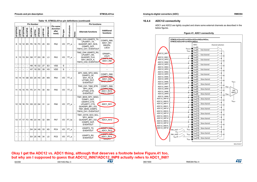

Can ST please match signals names used in RM and DS?
2022-10-21 1:27 AM
I even looked into the .xml whith CubeMX uses, and cannot see ADC1_INNx/INPx for 'L4 either.

Hello @Community member,
Thanks for reporting the issue.
You're right. ADC12_INN7 = ADC12_INP8 refers to ADC1_IN8 in DS
I confirm this issue and I reported internally for correction in the coming release.
Internal ticket number: 137973 (This is an internal tracking number and is not accessible or usable by customers).
