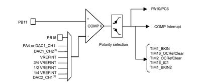

more interesting question is about comparator and UART... and i bet it is possible too ...

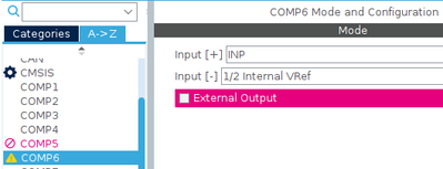

I just tried, on F303 :
Cube allows only comp6 output on pin PA10, usart1 rx then on pin PB7; need wire to connect.
And from rm see possible internal connections:
-> no internal connection to any uart - so not possible by internal mux .

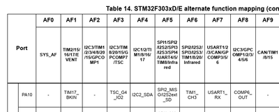

Now try to set "manually" the connection comp6 output on pin PA10 and usart1 rx :
from ds -> af settings:

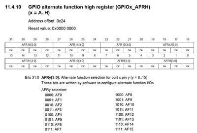

and sett to port register:
Decide yourself : how to set AFR10 to 7 and 8 at same time ?
So Cube is "right" here, only one position of internal pin mux possible.
And you lost the bet...  :)

Try to set it in Cube, then you see : possible - or not.
You can set maybe two input mux on same pin, lets say two ADCs on same pin.
Or set a pin as COMP output and ...
