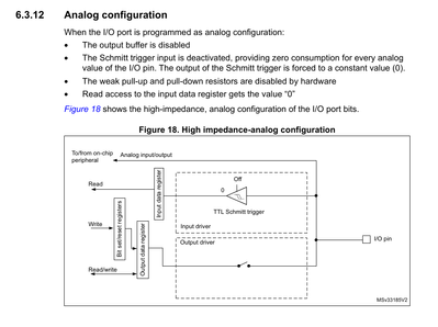

Hi all,
I'm working on a very low power custom board powered by a STM32C011D6Y micro controller.
I must read an ADC input routed to F1 ball (PA3, PA4, PA5 or PA6) but I'm measuring some strange power consumption related to the input voltage on the pin.
For example:
 - I configure PA5 as ADC_IN5
 - I wire F1 directly to an external signal generator
When I inject with the signal generator about GND or Vdd (about 3V) on the ADC input pin, the board's power consumption seems to be fine. When I set the input voltage about at half scale (about 1.5V) I measure about 500 uA on the power supply side.
All the other ports are set as analog inputs with no pulls.
Trying to figure out the problem I tried to configure other ports, for example PA3 as ADC1_IN3 on the same ball but the power consumption is exactly the same.
I also tried to rewire the board so that the analog input is connected to ball E2 (PA7, PA10 or PA12). On this pin I measure the same issue but with less power consumption, about 150 uA.
I read on the errata that there's a bug in the revision A (2.2.2) that says that on PA11 the Schmitt trigger remains effective in analog input mode. The bug should be resolved on the revision Z of the silicon (the one I have). The behavior I'm observing seems to be exactly the same as the Schmitt trigger remains active but in all the pins I tested (PA3, PA4, PA5, PA6, PA7, PA10 and PA12).
In addition, when I configure ADC1_IN7 on PA7, ball E2, and set to analog input PA12 I can read the input signal on GPIO's IDR as PA12 was a digital input. From the datasheet I expected to read 0 because the input Schmitt trigger should be disabled and logic value forced to 0.
I suspect that I measure an higher current consumption on F1 ball because there are more pins connected to it respect to E2. Even if the pinmux selects PA5, the other 3 optional pins  seem to be internally connected to input signal.
I attach the relevant part of the code, mostly generated by CubeMX. As I tried to show you it is the code of a single test while I tried a lot of different configurations and wiring, all showing the same behavior.

Sadly I have to squeeze any micro amps from my board so this behavior is very important. Am I doing something wrong in the configuration?

SarcasticLama
thanks a lot for the replies, I really appreciate it!
I think I already configure all the pins as analog.
I'm injecting a DC signal into E2 ball and I configured using the STMCubeMx the ball to be controlled by PA7, ADC_IN7.
If I look into the registers using the SWD debugger I can see:
 - GPIO PORT A (address 0x50000000):
        MODER: 0x2BFDF7F7
        PUPDR: 0x24000000
 - SYSCFG (address 0x40010000):
        CFGR1: 0x0
        CFGR3: 0x800
If I'm not misinterpreting I think that the 3 pins connected to E2 ball (PA7, PA10 and PA12) are all set as analog with no pull. There's no remapping of PA12 and the ball is assigned to PA7 (as CFGR3 says).
If I'm correct ADC configuration is not an alternate function so PA7 (the one I want to use) should be set as analog.
Now, with Vdd about 3V:
 1) if I inject 0.5V into E2:
       I measure the board supply current as 2.630 mA
       GPIOA IDR: 0x7F
 2) If I inject 2.5V into E2:
       GPIOA IDR: 0x107F
 3) If I inject 1.5V into E2:
       I measure the board supply current as 2.795 mA
       GPIOA IDR: 0x107F
So, the things I can't understand are why:
 - Why I see 165 uA of extra current if the digital  frontend (Schmitt trigger) is disabled?
 - Why i see the input data register of GPIOA reflecting on pin 12 the state of the input voltage if the digital  frontend is disabled? The reference manual (6.3.12, figure 18) says that the input should be read as 0
Also the bits of GPIOA IDR related to other pins don't look correct if I'm not missing anything: for example PA0 is set as analog (watching the same MODER register value as before) but into the IDR it is set to 1.
Am I missing something or the pins that should be set as unconnected are somehow left with the digital input stage enabled?
Thanks a lot
