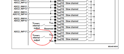

Now I had a closer look in the registers. For my device the RM0440 is the right one. My ADC does not have an ADC_CHSELR Register.
  • According to Figure 85, OPAMP3 is connected to Channel 18. The Other Inputs I use are Channel 3, 4, and 8.
  • All the inputs are selected correctly as single-ended inputs. (DIFSEL=0)
  • Channel Selection seems correct. This is given by SQR1. Bits SQ1 are 0x3 (Channel 3), Bits SQ2 are 0x4 (Channel 4), Bits SQ2 are 0x8 (Channel 8), and Bits SQ4 are 0x12 (Channel 18). Bits L are set to 0x03 (Corresponds to 4 conversions).
  • All other Sequence Regsiters are 0x0
  • Channel-wise programmable sampling time seems correct. SMP3, SMP4, SMP8, and SMP18 are set to 0x7 in SMPR1 and SMPR2.
  • All other registers also seem ok to me,
I wonder a little bit what the second switch in figure 85 is about. As far as I understand, the channel select bits only control the switches on the right side in the following picture:
I wasn't able to find further information on this. According to table 201, the adc input is connected internally to the OPAMP3_VOUT when OPAINTOEN bit is set. Do you think that this might be the second switch? However, the bit is set in OPAMP3_CSR. So everything seems fine here.
I also read Chapter 11 about the periphals interconnect matrix. But unfortunately I did not find anything here (Some connections are disabled in low power modes, which I do not use).
I think so, swith is likely the same as shown in this picture:Figure 170. PGA mode, internal gain setting (x2-x64).png

Fortunately, I also had a NUCLEO-G474RE flying around. The observed behaviour can be reproduced by shorting PB0 (posiitve input of OPAMP3) to ground. It turns out, that the line
HAL_OPAMP_SelfCalibrate(&hopamp3);
 does make a difference. Without the calibration function I get the expected output. When I call the function after the initialization, the output is somewhere between 0.4 and 0.5 Volts. So I think that I might use this function wrong or there is some bug inside. For me, I could live without the calibration function.
For everyone else, I attached the NUCLEO-G474 Project to reproduce the observed behaviour. The form does not allow me to upload the exported *.zip-File from STM32CubeIDE. So I can only provide the main.c and the CubeMX configuration.
