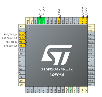

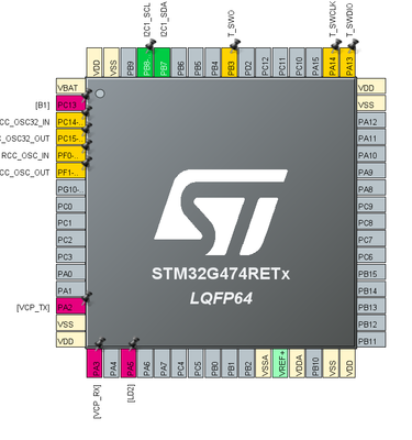

And now for the other interesting bug I found.
Below is a pinout view at this point in time.
To kind of fix this, I then go to the Bsp category, click on NUCLEO-G474RE and uncheck the Human Machine Interface. This then, rightly removes the reservation on the pins for the UART, LED and Button
I click Save and then Build. No more errors. But I want the BSP enabled so I go back an enable the Human Machine Interface. The pinout configuration remains the same, as per the above config even though the LED, Button (Set to EXTI) and VCOM port are checked. This behaviour I do not believe is correct so I uncheck and disable the LED, Button and VCOM port and then reenable them, when I do this, the pinout view now shows the expected reservations.
