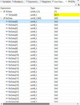

I am currently working on a Battery Management System (BMS) and an instrument cluster. I need your assistance with some issues I’m encountering while communicating between the BMS and a custom cluster board using CAN.
We have two custom cluster boards equipped with STM32F098RCT6 MCUs and TJA1042 transceivers. I successfully established communication between the two boards and received the RxData in the debug terminal.
When I attempt to establish communication between the cluster board and the BMS, no data is received in the debug terminal. Despite numerous attempts, I have been unable to achieve successful communication.
Please provide some insight about this.

if (HAL_CAN_AddTxMessage(&hcan, &TxHeader,(uint8_t *)TxData, &TxMailbox) != HAL_OK)
Error_Handler();
HAL_GPIO_TogglePin(GPIOC, GPIO_PIN_11);
HAL_Delay(500);

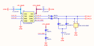

To me there are two issues from what provided as code:
1- You are using HSI instead of HSE with an external crystal:
RCC_OscInitStruct.OscillatorType = RCC_OSCILLATORTYPE_HSI;
RCC_OscInitStruct.PLL.PLLState = RCC_PLL_NONE;
2- Bad BS1 and BS2 parameters. You need to increase as much as possible BS1 and BS2 where BS1 = ~(70% to 85% (BS1+BS2) and decrease the preclear as much as possible:
hcan.Init.TimeSeg1 = CAN_BS1_1TQ;
hcan.Init.TimeSeg2 = CAN_BS2_2TQ;
Also what is the bitrate you are using for CAN communication? are you sure you set the same CAN bitrate?
Could you please also your schematics? especially CAN part STM32/Tranceiver.

What debugging and instrumentation do you have at each node?
Do you have a CAN Bus Analyzer?
2024-10-24 4:16 AM
We have a DSO and CAN to USB converter.
2024-10-24 4:20 AM
And what debugging and telemetry is available to understand the state and dynamic behaviour of the nodes ?
2024-10-24 4:23 AM - edited 2024-10-24 4:28 AM

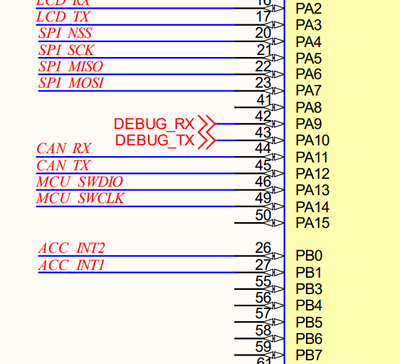

2024-10-24 4:35 AM
We require a bitrate of 500,000 bps. To achieve this, I selected the appropriate prescaler, BS1, and BS2 parameters.
Here is the schematics:
In the transceiver, we grounded the STB pin.
2024-10-24 4:37 AM

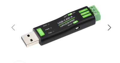

2024-10-24 4:41 AM
Here is the screenshot of USB to CAN adapter model.
