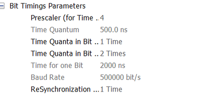

I am currently working on a Battery Management System (BMS) and an instrument cluster. I need your assistance with some issues I’m encountering while communicating between the BMS and a custom cluster board using CAN.
We have two custom cluster boards equipped with STM32F098RCT6 MCUs and TJA1042 transceivers. I successfully established communication between the two boards and received the RxData in the debug terminal.
When I attempt to establish communication between the cluster board and the BMS, no data is received in the debug terminal. Despite numerous attempts, I have been unable to achieve successful communication.
Please provide some insight about this.

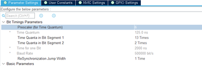

2024-10-24 5:20 AM - edited 2024-10-24 5:21 AM
2024-10-24 5:45 AM - edited 2024-10-24 5:55 AM
@DivyaJayan wrote:
Here you didn't change anything in the timing!
And this is what I propose for your bitrate:

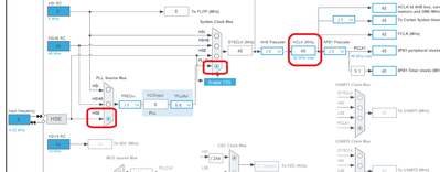

Also I'm wondering why are you using the product at 8MHz?
This is a config at 48MHz:

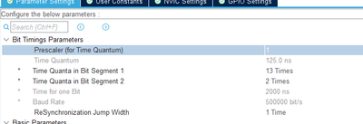

In that case I propose these timings config:
2024-10-24 9:17 PM
I adjusted the timing parameters as you recommended, but there hasn’t been any improvement.
2024-10-25 12:25 AM - edited 2024-10-25 1:05 AM
You need to ensure that BMS is sending frames to STM32. Did you verify that with an oscilloscope or CAN bus analyzer ?
