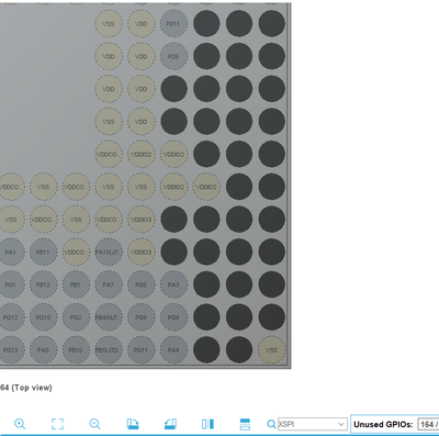

The first step to do: did you check if the OSPI/XSPI lines are all exposed over the connectors available le on the board?
January 29, 2026

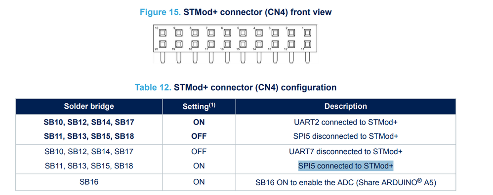

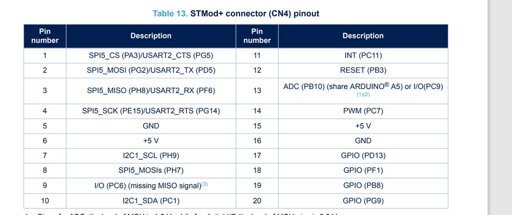

From the Following Manual we can access only the SPI5 pins through the connector pins the XSPI Pins are in the labels of PP,PO,PN as attached in the image below
If the XSPI/OSPI pins are not exposed through connectors, does that mean they cannot be used for communication with external peripherals? Are these pins dedicated exclusively to external memory devices on the board?
Additionally, if it were possible to access those pins, could they be used to communicate with an external peripheral via XSPI in a manner similar to how SPI5 is used through board connectors for peripheral communication?
Now could you clarify the doubt , the pins not available means cant we use them for external peripheral , and are they only dedicated to the mem only , and suppose if can we able to access those pins can we use them to with external peripheral with XSPI as how we using SPI5 with external Peripheral through connector

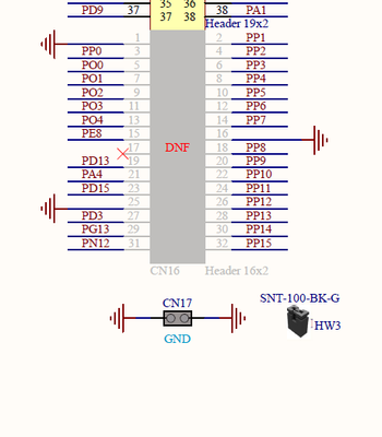

In the STM32 Nucleo-144 board of chip having N6570 as mentioned in the manual those pins of XSPI/OSPI are exposed here out to readily use , the only concern is that can we solder and use them for external peripheral or also those are dedicated to connect only the highspeed Mem?

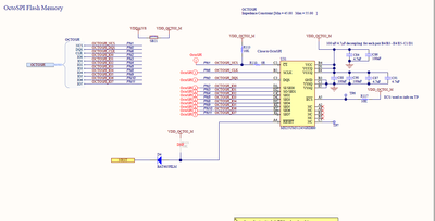

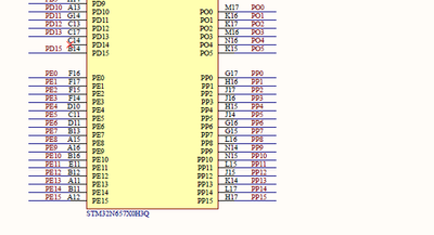

I think in the Nucleo F144 MB1940 the PO and PP series are open to use including the chip select , the OSPI Flash Mem is on the Pins of series PN , can we use the PO and PP series to communicate using the OSPI  , and the external peripheral is not the Flash Mem , consider it as an Soc / ASIC , just tell me at upto 100 MHz with proper on board wiring [to avoid all the signaling issues] , just can we able to communicate with the external peripheral [Soc/ASIC] as like as general SPI
in simpler way my doubt is can we use OSPI/XSPI with external peripherals such as ASICS/SOC as like as SPI
