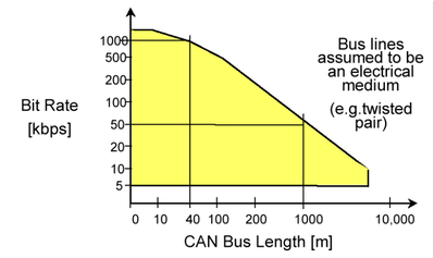

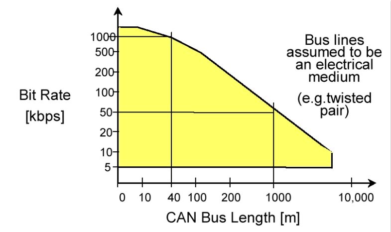

  1. Incorrect CAN configuration: Mismatched CAN/FDCAN configurations between nodes can lead to reception issues, including the correct baud rate (all nodes must have the same bitrate). Furthermore, incorrect timing settings, such as the CAN prescaler, TSEG1, and TSEG2 and incorrect sample point selection lead to communication issues. Incompatible bitrate versus bus length could also be an issue. CAN bitrate is limited by the bus length: The more you increase the CAN bitrate the more you need to decrease the bus length:
    Image reference: https://www.researchgate.net/figure/CAN-transmission-speed-depending-on-the-bus-length-7_fig1_328227438Image reference: https://www.researchgate.net/figure/CAN-transmission-speed-depending-on-the-bus-length-7_fig1_328227438
