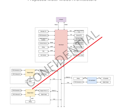

Hello ST Community,
I am working on an industrial combo vending machine controller system and would like to request a design review / best-practice feedback for an architecture based on STM32H563ZIT6.
System Overview
  • MCU: STM32H563ZIT6 @ 200 MHz
  • Operation: Industrial application, 24×7 continuous operation
Architecture:
  • Main / Process Controller
  • Stepper Motor Controller
  • DC Load Controller
Each controller uses a dedicated STM32 MCU to separate process logic, real-time motor control, and power load handling.
1. Main Controller – CPU Load & Memory Utilization
  • Multiple interrupt sources (flow sensors, actuator pulses, PWM capture)
  • UART RS485 communication @ 115200
  • ADC usage with DMA
  • Continuous vs process-based CPU load classification
  • Worst-case CPU utilization < 20% (**Please check our attached Doc)
  • RAM usage ~4.4%, Flash usage ~4% (Build Analyzer)

1- I'm wondering about the document confidentiality of the first attachment. It's marked as a confidential document. Are you sure to share that in public?
2- The CPU load / memory size depends on your tests and your application we cannot confirm if STM32H563 is 100% suitable for your application. You need to run some tests and make your assessment.
Edit: image removed.

The architecture makes possible the usage of multiple interrupts in parallel but you need to assess how to configure each interrupt priority according to your constraints.
There is no specific documentation specific to your application but I can suggest you the AN5872 "Introduction to the system architecture and performance in the STM32H5 MCUs"
