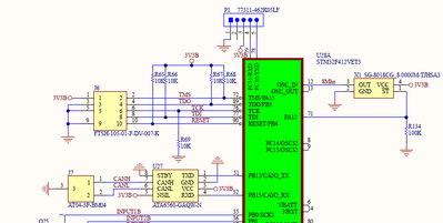

When I set the CAN Mode to LOOP BACK the transmission works fine.
Interrupts: 0x2, msr flags: 0xC08 , tsr flags: 0x1C000003, rf0r flags: 0x0, rf1r flags: 0x0, esr flags: 0x0
Interrupts: 0x2,msr flags: 0xC08,tsr flags: 0x1C000003,rf0r flags: 0x0,rf1r flags: 0x0,esr flags: 0x0
When I run the same code in Normal Mode The same transmit message fails.
hcan2.Init.Mode = CAN_MODE_NORMAL;
Interrupts: 0x2, msr flags: 0xC08 , tsr flags: 0x19000008, rf0r flags: 0x0, rf1r flags: 0x0, esr flags: 0xF80057
Interrupts: 0x2,msr flags: 0xC08,tsr flags: 0x19000008,rf0r flags: 0x0,rf1r flags: 0x0,esr flags: 0xF80057

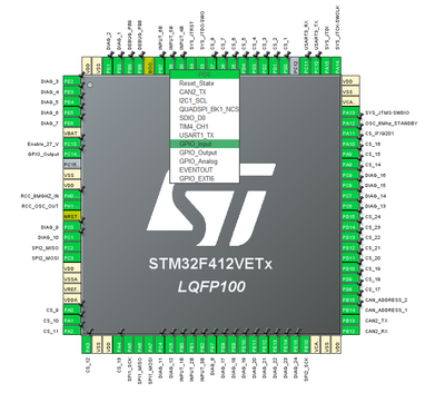

I have to assume that my transceiver must be the problem.
Can2 has another port pin but I think I selected the GPIO ports correctly.

‎2024-03-15 8:53 AM
Not sure I can see the resistor but ok.
Now please check your bitrate and see my previous comment:
I have a Pcan Dongle hooked up and it is configured to 250Kbits per second and I have verified
You said you configured your PCAN at 250kb/s but from your ioc file the bitrate is set at 500kb/s!
Could you please double check? (changing the Prescaler (for time Quantom) to 8 instead of 4)"
‎2024-03-15 9:11 AM
I ordered an eval board for the ATA6560 transceiver and I will connect it to my NUCLEO-F412ZG board and test the same CAN code that I have in our current PDM target board. The CAN is the last thing I need going to finish the Power Distribution Module (PDM) firmware for the first prototype.
‎2024-03-15 9:34 AM
The STM32F412 uses CAN 2.0B protocol. Not that it won't work, but you don't need a CAN FD transceiver. Since you're using a Microchip product, use the MCP2551 transceiver.

‎2024-03-15 9:41 AM - edited ‎2024-03-15 9:42 AM
Referring to the ATA6560 datasheet, you may face an issue regarding the VIH level:
As I assume the MCU VDD is at 3.3V, the Tx level voltage can't exceed 3.3V for a recessive bit.
VIHmin of the transceiver = 0.7xVVIO. As ATA6560 version does not have VIO pin, VIO = VDD = 5V (power supply: VVCC = 4.5V to 5.5V).
--> VIHmin = 0.7 x 5 = 3.5V > 3.3V (the IO voltage max of the MCU). So the transceiver can't see high level on its Tx pin from your MCU!
‎2024-03-15 9:48 AM
From voltage levels adaptation standpoint MCP2551 is good as VIH min = 2V:

We installed the new ATA6561 CAN transceiver and have the 3.3V on the VIO pin and VCC is connected to the 5.0V supply. I am not seeing any activity on the TX or Rx lines when I try to transmit from the Proto PCB or when I send a CAN message to the Proto PCB using my PCAN tool.
‎2024-03-27 2:44 PM
Hello your the selection of ATA6561 doesn't present an issue.
But since you're not seeing any activity on CAN_Tx pin of STM32, are you sure about the GPIO config? are you sure you selected the correct alternate function that connects CAN_TX to the transceiver?
You need to start at this point ..You need at least to have an activity on CAN_Tx.
‎2024-03-28 7:00 AM
SofLit,
I started looking at the GPIO port pins and it turns out that between Me and the hardware designer we swapped the TX and Rx pins on the schematic. Going back and double checking the pin assignments in the ST32CubeMX tool helped point out the mistake.
Thanks for your help.
