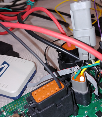

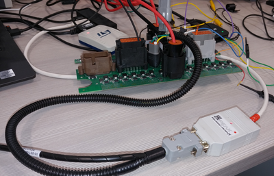

You haven't mentioned what you're trying to send a CAN message to? If you haven't connect your CAN wires to any other CAN bus, then you'll get transmit error.

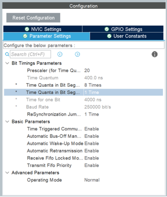

Three things to check:
  • Is there a second node connected on the other side of the bus? As the sender needs an acknowledgement from at least one node on the bus.
  • If yes, are you using HSE or HSI as system clock source?
  • Did you set the same bitrate at both sides (the two nodes)?

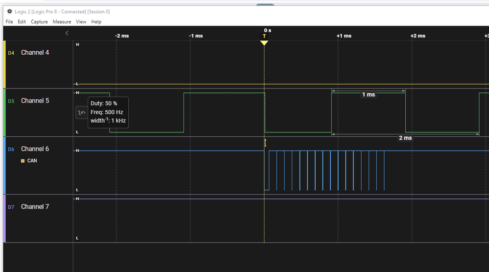

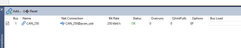

JDOG
I have a Pcan Dongle hooked up and it is configured to 250Kbits per second and I have verified that it is working with hardware that is transmitting messages.
The bit rate is set at both places at 250 Kbits per second
Yes I am using the HSE as clock source.
The 1 ms clock tick is being generated from a PLL clock so I know the clocks are working off of the 8 Mhz clock
When I send the transmit message I  get the CAN error on channel 6 Blue Trace.

Check also your connections and wiring by doing continuity tests.
What about the termination resistors? Is there a termination resistor inside the PCAN? I don't seen one on the schematics above! You need only two termination resistors of 120ohm on each side of the bus .
Could you please also provide a diagram of your connections including the perceivers and the termination resistors to have a clear view of your HW?
PS: This is NOT an online support (https://ols.st.com) but a collaborative space. So please be polite in your reply. Otherwise, it will be reported as inappropriate and you will be permanently blacklisted from my help/support.

I Attached the *.ioc file as requested.
You said you configured your PCAN at 250kb/s but from your ioc file the bitrate is set at 500kb/s!
Could you please double check? (changing the Prescaler (for time Quantom) to 8 instead of 4)
Based off your ABP1 clock, you'll need these settings for 250kbs

The 120 ohm terminator at the CANH and CANL side of the Transceiver is attached with soldering the wires to the (greeen and yellow wires).
There is a terminator in the PCan dongle as well.
