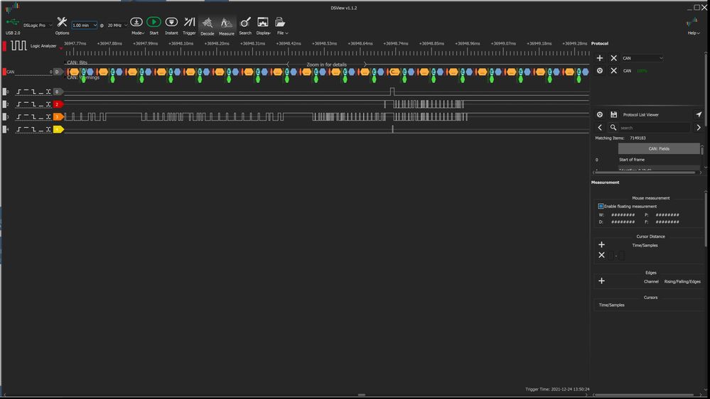

I am implementing CAN communication with an inverter and sometimes experience communication failures. The inverter is the only one sharing the bus.
The interface is setup @500kBaud, STM32F407 (revision 2) 100pins, CAN1 (A11,A12) and works fine except getting this strange behavior sometimes, which I can't understand.
I use interrupt driven Receive and cmsis CanTransmit fct.
SCE ISR just clears errors:
   CAN1->ESR = (uint32_t)RESET;
   CAN1->MSR = CAN_MSR_ERRI;
From that point on the inverter transmits corrupted frames for about 10s until it sort of recovers.

I do not understand why the TX-Line is being activated interfering the ongoing transmission with a well shaped pattern.
What did I do wrong and how can the CAN TX line be activated without sending or receiving ? Is this part of the BUS arbitration and what is the condition that forces the CAN controller to behave like that (all queues empty).

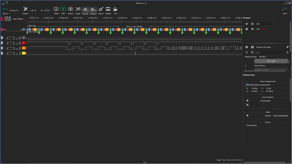

using B5 and B6 as debug pins (see the diagrams)

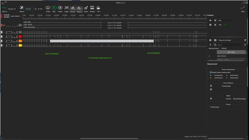

This problematic sequence only occurs once and can be reproduced. The ONLY time (even for hours) the SCE interrupt occurs is at this event.

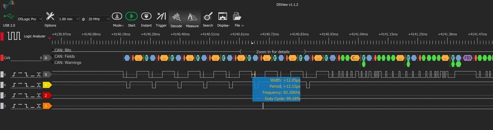

But you see in the detailed diagram that the boinks are well aligned before the "problematic sequence" and communication resumes after the re-transmission stopped.

But the frame has just begun when the "boinks" are interfering transmission. An ACK signal is 2uS long but these 8 boinks are 12uS and ALWAYS 8 successive ! And how can the CAN controller detect a frame error when it does not even allow transmission of the frame and interferes 12 uSecs after dominate signal ?

btw: this is when the situation recovers after hundreds of ignored frames the other side changes the frame and this is then accepted.
0693W00000HpkYxQAJ.jpgThe "big picture" so when the problem starts (see waveforms) anf how it recovers after ~15seconds.

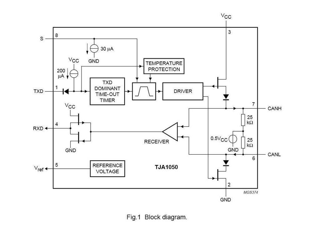

I think the open drain does not make a difference as the CAN chip uses Push pull output circuitry:
