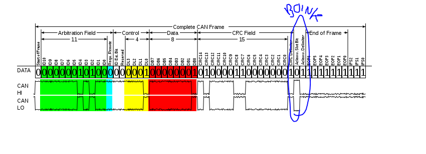

Hello Community !
I am implementing CAN communication with an inverter and sometimes experience communication failures. The inverter is the only one sharing the bus.
The interface is setup @500kBaud, STM32F407 (revision 2) 100pins, CAN1 (A11,A12) and works fine except getting this strange behavior sometimes, which I can't understand.
I use interrupt driven Receive and cmsis CanTransmit fct.
SCE ISR just clears errors:
CAN1->ESR = (uint32_t)RESET;
CAN1->MSR = CAN_MSR_ERRI;
From that point on the inverter transmits corrupted frames for about 10s until it sort of recovers.
My CAN-Init:
CAN_InitStructure.CAN_TTCM = DISABLE;
CAN_InitStructure.CAN_ABOM = DISABLE;
CAN_InitStructure.CAN_AWUM = DISABLE;
CAN_InitStructure.CAN_NART = ENABLE;
CAN_InitStructure.CAN_RFLM = ENABLE;
CAN_InitStructure.CAN_TXFP = ENABLE;
CAN_InitStructure.CAN_Mode = CAN_Mode_Normal;
CAN_InitStructure.CAN_SJW = CAN_SJW_1tq;
I am a bit new to CAN-Bus so the solution might be very trivial.
I do not understand why the TX-Line is being activated interfering the ongoing transmission with a well shaped pattern.
What did I do wrong and how can the CAN TX line be activated without sending or receiving ? Is this part of the BUS arbitration and what is the condition that forces the CAN controller to behave like that (all queues empty).
Thank you for reading all this !
Tom

‎2021-12-24 2:19 AM
I think That Tx blimp you see is the canbus peripheral ACKing the received message.
Or it could be noise, anyway, using the analog readings (osilloscope) will give you a lot more info about what is going on.

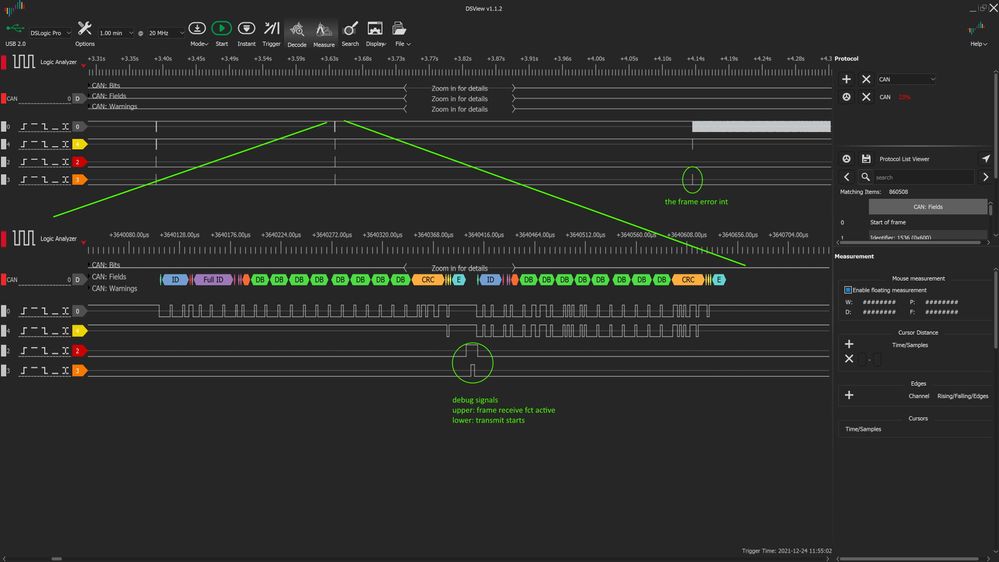

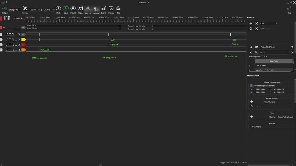

‎2021-12-24 2:52 AM
Hello Javier,
These boinks would be very misaligned and way too fast if you consider the first 8 of them.
Seems the CAN controller lost sync and the retransmitted frames (in the above example) are maybe ACKED but the according frames not received.
After six boinks the STM32 seems to recognize the problem (it caused by itself) and raises frame warning/error interrupt (see the circle).
But it is unfortunately not able to resync the bitstream. Only when the sender stops successive retransmission communication continues and stays stable for hours then.
This is the picture of regular frames and the point when things screw up.

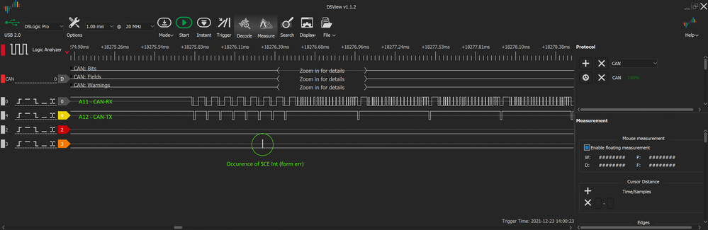

‎2021-12-24 3:28 AM
@Javier Muñoz​ ,
From the picture of his first post, a Form Error interrupt is raised. So the issue comes from the frame structure itself.. That's why I'm suspecting a hardware issue.
