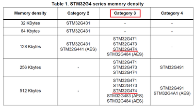

I'm facing the issue of PB4 going high for 27ms approx after MCU reset. My design is freezed, And this pin is connected to a relay which turns ON when this pin goes high. The relay turn on time is 7.5ms. Is there a solution in code initialization so that this pulse stays below 7.5ms. I'm attaching the waveform.
mƎALLEm
There is an internal pull-up activated during reset and the device you have (STM32G474) and according to the reference manual RM0440 belongs to the category 3:
which doesn't feature the option byte to disable that internal pull up.
So the internal pullup is internally hardwired in your device (category 3). Not possible to deactivate it.
The 27ms duration you are seeing depends on the reset assert duration on NRST pin.
The internal pull-up resistor value is around 40K. The only thing I can suggest is to add an external pull down resistor to make a resistor divider on the GPIO output to compensate that voltage.
Meanwhile you need to make sure you calculate that resistor in a such a way the output voltage during the reset phase is lower than the VIHmin of your relay circuit activation.

As discussed on the linked thread, use an external pulldown or a different pin. You cannot change the pin behavior at reset.
