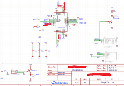

I have a problem with a custom board, where i can not enter bootloader, on some boards...
I had a production where around 10% has this issue. (I did not see it on earlier production of 5pcs).
The problem is the cube programmer will not enter bootloader mode.

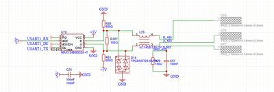

I use a autodirection rs485 tranciever (5V on FT pins) and it is working on many of the boards with no problem, also the in-application code works fine for modbus (also on the bootloader broken devices, after programming with ST-Link)
I am using a FTDI USB to RS485 converter.
The boot pin is held up by a hall sensor and inverter transistor, i have noticed these sensors has different startup time 50-100ms - therefore the MCU reset pin is controlled by a rather slow RC circuit, to ensure boot is high before reset is released. (this is a litle risky).
However, i can see on the current consumption when it goes into application mode or assumed bootloader mode, as in bootloader mode the current stays much lower.

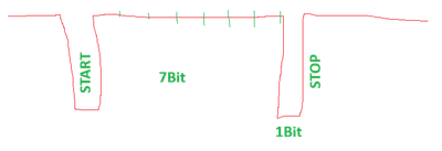

I can see on the RX pin of the tranciever it recieves the 0x7F from cube programmer and i can measure it close to the MCU pin (UFQFPN). But there is none answer from the MCU on TX pin.
Remember the communication is working without errors in application mode, also only with autodirection.
I have tried to short the boot0 to 3V3 with same result, i have tried to have long and short reset pulse time, same result...
I have sometimes managed to get the failing board to enter the bootloader, and then it does it several times in a row, but will stop work again.
I have tried to run the PC of battery, short the pc and lab psu together to ensure common mode voltage, but the recieved signal out of the tranciever looks good, and equal to a working device, i calculated baudrate/timing and it was ok...

There is added pullup between pin 2 & 3 on the rs485 tranciever 10K.
I really do find this strange, i have been thinking about noise on pins there keeps the bootloader IRQ too busy.. but have not seen such thing.
I have not changed any options bytes, i have checked the Boot1 flag and the SWboot flag, not changed and seems correct.
There seems no glitches on the supply lines.
Boards are produced by JLC, could there be counterfight chips?
I have worked with STM MCU for many years, but this issue seems new to me...
I hope you can give me some hints

UART signal
  • 0x7F waveform verified on MCU RX pin
  • Clean edges (fast rise/fall)
  • Low level < 0.5V
  • High level ≈ 5.0–5.2V (pin is 5V tolerant)
  • Minimal ringing observed
Timing
  • Measured ~832 µs from start bit to end of 7 data bits → matches 9600 baud
  • No baud mismatch observed

:electric_plug: RS485 / Hardware Details
  • RS485 auto-direction enabled via:
    • PB3 connected to TX enable control
    • 10k pull-up used to default direction
  • Important:
    • PB3 is floating during bootloader (GPIO default state)
    • External circuit defines transceiver state
  • Verified:
    • 0x7F passes correctly through transceiver
    • Signal integrity looks correct on both TTL and differential sides

For the RX/TX, on TTL level, Trigger on RX, the signal starts high, then there is a single start bit, and in the end before the high stop bit there is the 1 bit low... It is 5V signal, have nice edges and low level below 0.5V.
according to chatty the timing fits, from first falling to last falling and 8bit time.
On TX pin there never comes any signal :(
