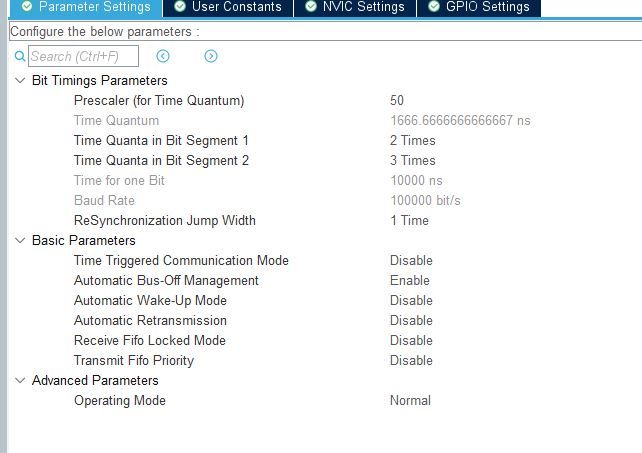

I'm using STM32F446RC controller CAN BUS 1. Trying to operate CAN BUS at 1mbps speed when using 100kbps bit rate it is working fine but not at 1Mbps bit rate. Is there any solution for this.

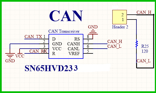

Could you please provide more details about your HW: provide schematic + bus length

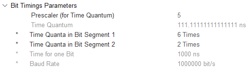

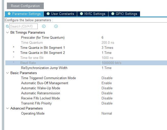

I tried it in loopback mode also but it does not works. I am using main clock 180 MHz with other settings given below. I am attaching schematic and parametre details as bleow.0693W00000bhSeNQAU.png0693W00000bhSbdQAE.jpg

Given below are the details for CAN at 1 Mbps baud rate with Clock at 180MHz.0693W00000bhSfaQAE.jpg

The value 1 is very small for BS1 and BS2. You should select a prescaler value as less as possible and BS1 and BS2 values as greater as possible with BS1 > BS2 where BS1 is around 80% of the sum (BS1+BS2).
So please try these values with a simple point at ~75%:
PS: This is NOT an online support (https://ols.st.com) but a collaborative space. So please be polite in your reply. Otherwise, it will be reported as inappropriate and you will be permanently blacklisted from my help/support.

I have tried these above mentioned parameters but still it does not work. It is working well at lower baud rates like 100kbps and 200kbps but not at 1mbps.

No, new parameters are not even working in loopback mode. I am using HSE Clock but even tried it with HSI but nothing works.

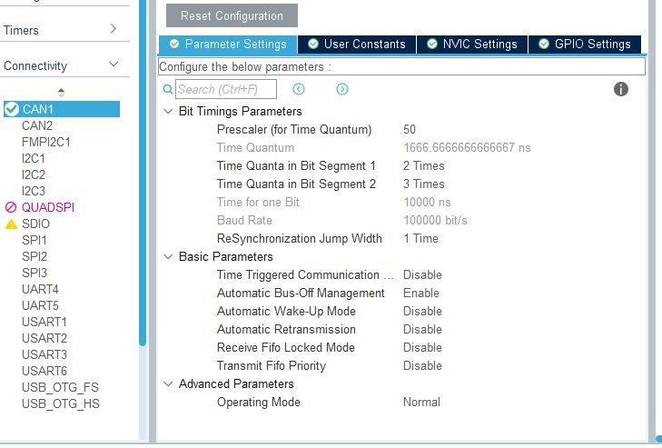

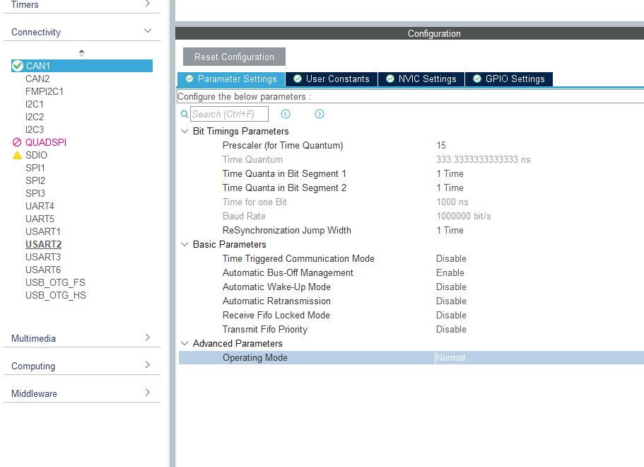

I have checked that if I use 60 MHz clock for 100kbps baud rate below parameters (attaching below) with HSE clock and HSI it works good in Normal and Loopback mode but if I use same clock 60MHz (tried with HSE and HSI both) for 1Mbps with parameters below given (attaching them also) even this does not work.0693W00000bhYEpQAM.jpg0693W00000bhYEkQAM.jpg

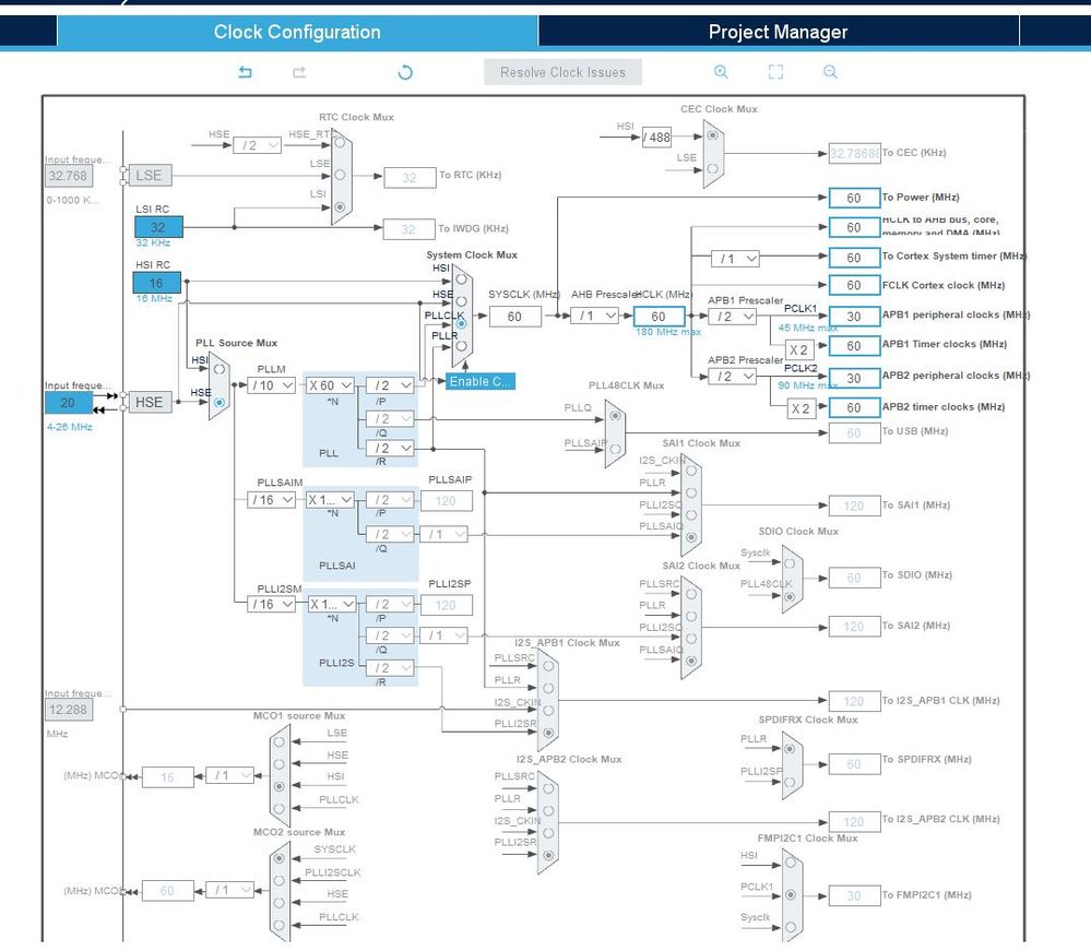

Could you please send you system clock configuration?
Could you also tell which board you are using?

@Community member​
I am using custom pcb which has STM32F446RCTx controller.
