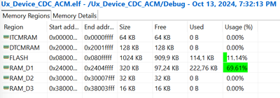

I have this usage bellow, but if I increase my buffer 1k more (I'm using 2x 50k) I receive this error: overlaps section ._user_heap_stack VMA
Is it possible to change the memory map to increase the buffer size?
For maximize sample buffer move all data to section for example DTCMRAM and sample buffer then have 320kB area self. 2x50k 16bit is simply 200kB and in config code is reservations for min heap and stack , now all this aranged into 320k area.
This also solved the issue of 0 in the beginning and end of the buffer.
