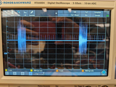

We have been using CANbus as our form of communication for a system with multiple nodes. Each node was individually tested with CAN and all of them work without issue. However, when we started system integration testing, we noticed significant noise on the CANbus channel that caused data to stop.

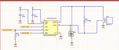

To give more details, we are running 2 battery packs, a power electronics DC/AC converters (to create a 120Vac signal) and a central supervisory controller, which are all using STM32 MCUs to communicate to each other via CANbus. We are using an STM32H7AGI6, STM32F401RE, STM32F303RE. When we send a CANbus command to start the DC/AC converter, that is when the noise appears and we cannot communicate with the MCUs until the DC/AC converter is turned off.
We have termination resistors at the end of the bus and I have verified that the 60 Ohm resistance is seen on the bus. I've also attached a copy of our schematic for the CANbus, which all of the nodes use (except that the 120 Ohm resistor is only populated in the two connected at the ends)
I've attached a picture of the waveform too, where the two "messy" segments are when we try to start the DC/AC converter. The picture below is the CANH line, with the probe grounded to the GND pin in the CANbus node.

So better cabling already ("real" twisted pair) improved things?
I would try shielded twisted pair next.
And maybe even this:
use shielded twisted pair cable with at least 2 twisted pairs,
1 twisted pair (CAN+ & CAN-), the other pair for the GND connection,
and with the cable shield only connected on one side, preferably with the shield not connected on the DCAC side.

The DC/AC converter is turned on and off via a CANbus message from another board, but communication is lost while it is running, so I have to manually turn it off (it's powered by a removable battery, so we just remove said battery to stop operation).
Hello LCE,
We are preparing to try shielded, twisted pair right now.
However, we continued testing and noticed that, once we put the unit back into our enclosure, even with the "real" twisted pair, the communication continued to freeze with no improvements from when I first posted the question. So now I'm questioning the twisted pair at all.
I am having a very hard time isolating this problem right now.

So a general update of my testing. We still haven't solved the problem, but we have identified something curious.
Our supervisory control board (which uses the same CAN hardware as the original post) is powered by the removable battery pack, which is the same one that powers the DC/AC. We tried a test where the supervisory control board is powered by a separate DC power supply, but kept everything else the same (DC/AC, battery pack, supervisory controller all connected via CAN, DC/AC powered by the battery, twisted pair cable, ground wire still connected) and the communication is never lost in this scenario.
Does this help explain it at all? Does anyone have any ideas based on that?
